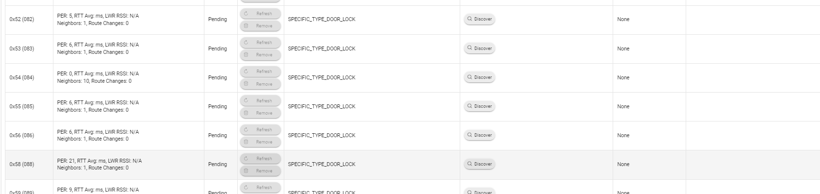

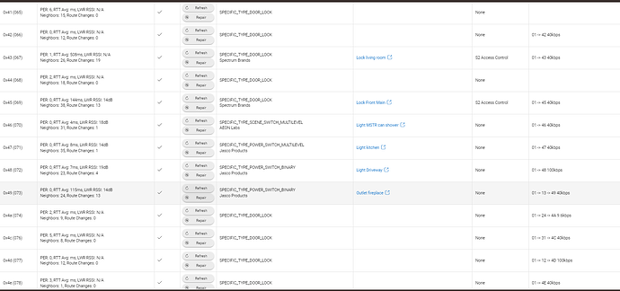

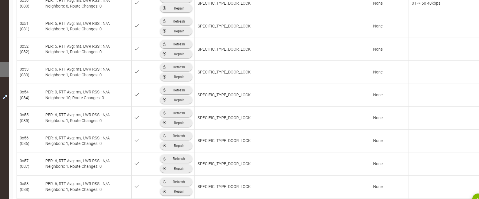

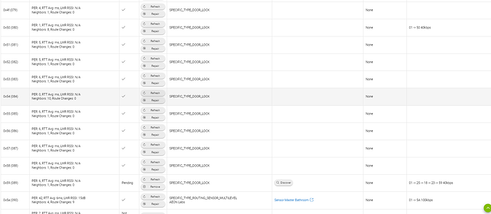

@rlithgow1 I took a look at the zwave Details and I saw a ton of "lock" entries. The full list is quite large. Perhaps this allows for some insight?
How do I remove all these, what appears to be, orphaned locks? perhaps causing all my problems?
The only insight we have from that screenshot is that you have created a large number of zwave ghosts that must be removed.
Can you post a screenshot of the **entire ** zwave details page?

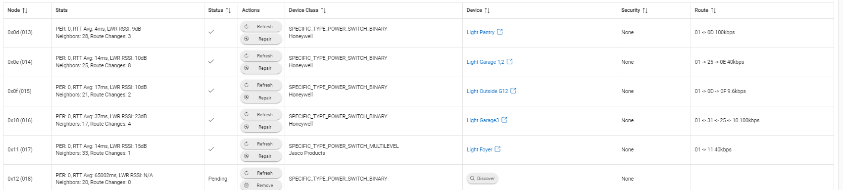

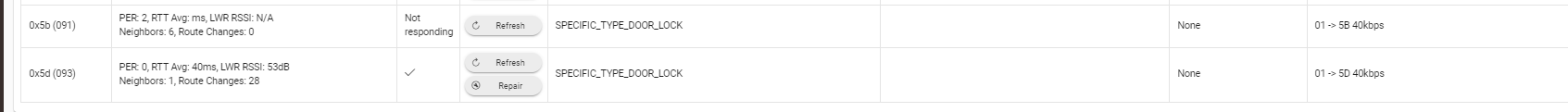

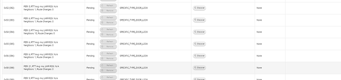

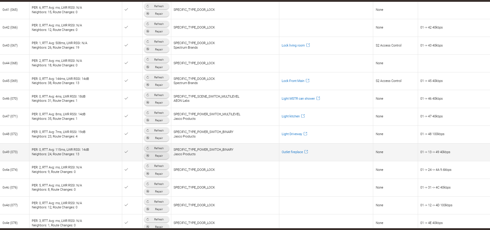

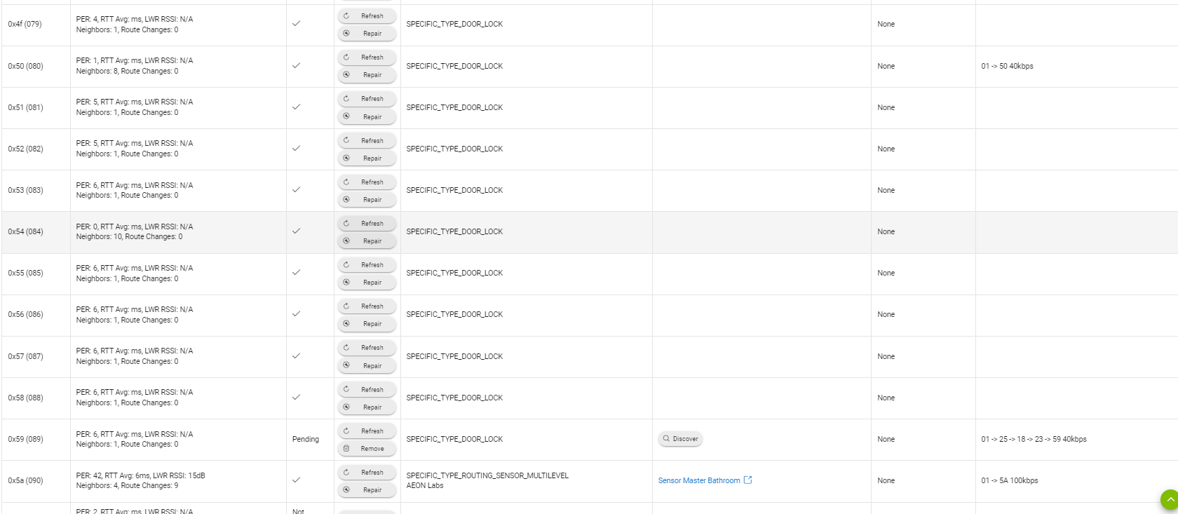

Every one of those without anything in the route column are ghosts and will prevent you from adding more devices and prevent your existing devices from working properly. Start by clicking refresh on a ghost line, then when it appears click remove. If this does not work for any of them, shut down power to the device that created the ghost and power cycle the hub (not just reboot) and then attempt to remove again. If this also doesn't work you will have to either use a z-wave stick to remove them or nuke the whole radio and start over. Your entire mesh is trashed.
ugh. So, I've been attempting to remove them, but seems like it doesn't always work. I'm guessing it is because the device is already active using a different ID and the ID that is incomplete is just causing problems?

another option is to connect up remotely (not close to all my stuff) and remove all ghosts? Only 12 more to go (that won't remove ...)
