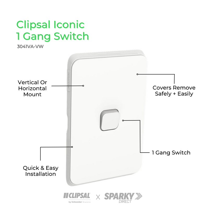

Just to be clear, the OP is an Aussie, we use a different z-wave frequency and 240v instead of 120v. Inovelli / Zooz / GE etc dont make Aus spec z-wave units.
The best options for Aussies are the Aeotec Nano range or Fibaro Micro range. I went with Aeotec Nano's as I didnt care about the extra functions that Fibaro offer (scene triggers etc).
You get your Sparky to install the modules behind your existing wall switches - I replaced mine with Clipsal Iconic Momentary/Bell press switch mechs and wall plates. they look amazing and work great.

I'm in Australia and I went the relay behind the switch route but found a few issues with Z-Wave signal strength and also needed to replace all light switches to not be rocker switches that looked on or off when the relay was in the opposite state. I also had limited space behind some of my switches.
