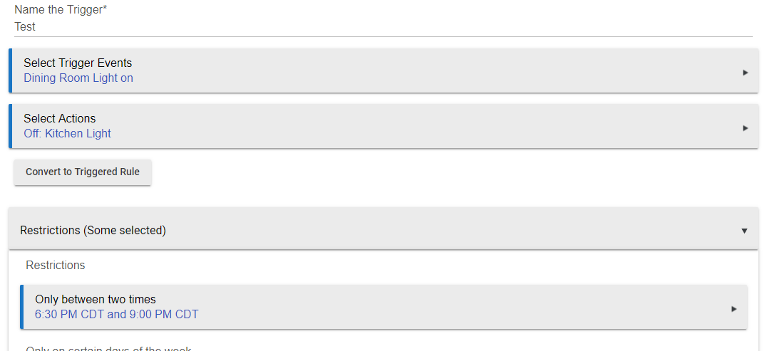

Define a trigger and place Breakfast light On as the trigger. Action would be turn off Kitchen light.
Then define a restriction between two times of 6:30 and 9:00.

Did you get it to work as you wanted?
Hi Scott,
Yes, it worked perfectly. I wanted the same rule for am and pm, so I tested it last night before 9pm and again after 9pm. This morning it looked good also.
I really do appreciate your help. Thanks.
Glad it worked!
