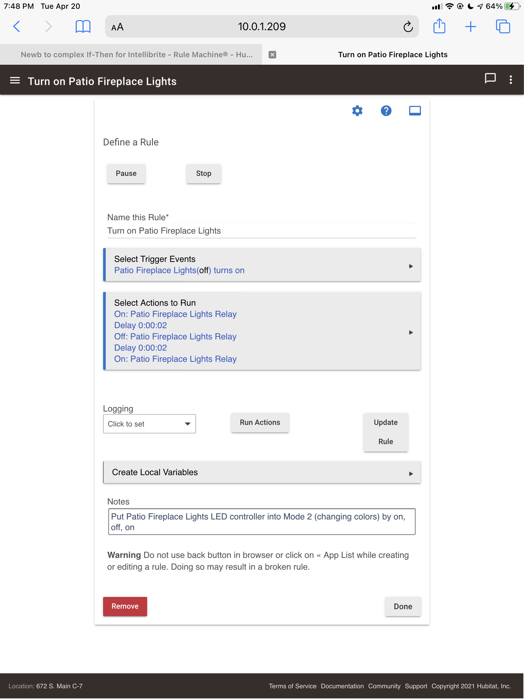

You haven’t provided enough information for me to write a sample rule for you, but we have a similar controller on our patio fireplace lights, hooked to a Zooz ZEN16. Here is my simple rule that we use, which may get you started.
