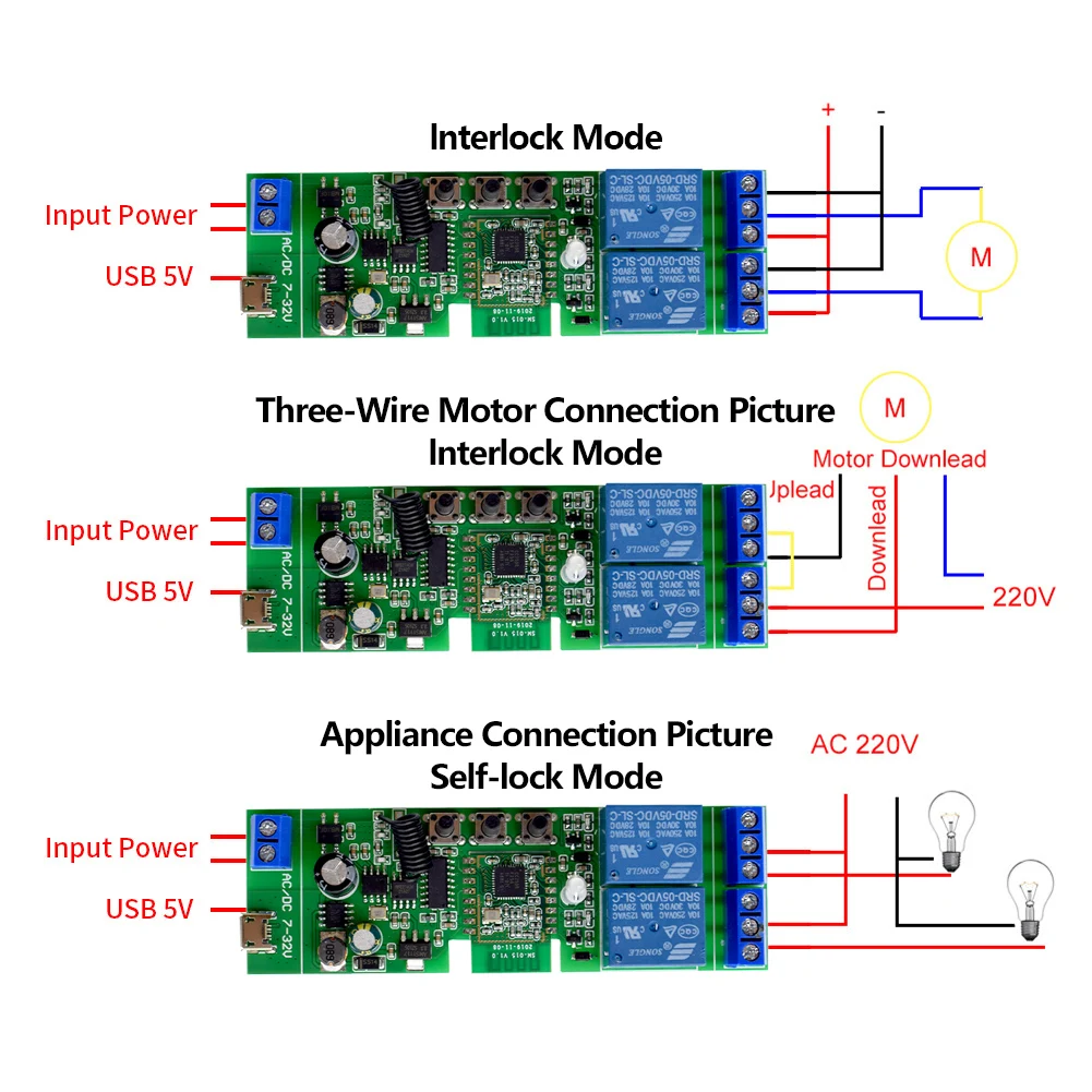

btw, I also have received the following device from Aliexpress:
I did not try it yet. It is a 5V (usb) powered 2 port relay.
Would it work out of the box or shall I need a special driver ?
edit: I just tried it and it works out of the box with a generic zigbee multi-endpoint switch driver
