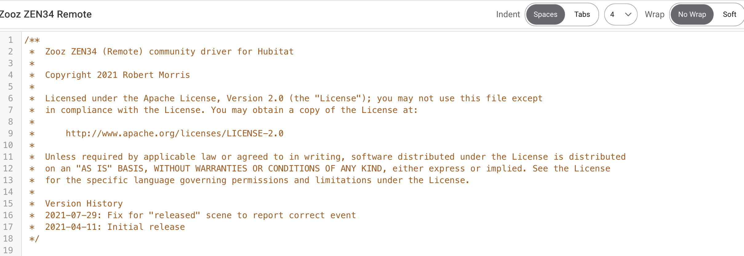

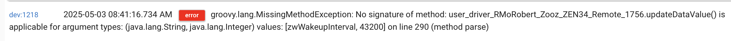

Pics of error log and driver specs below:

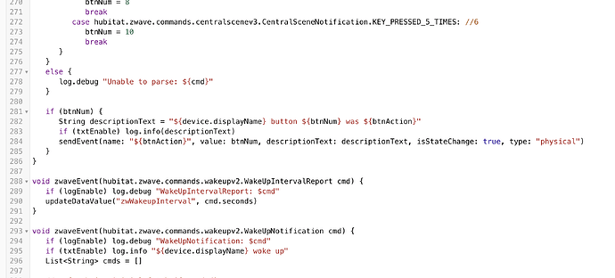

What does line 290 in the driver look like? Expecting something like:
updateDataValue("zwWakeupInterval", "${cmd.seconds}")
but the error message would seem to indicate it is more like:
updateDataValue("zwWakeupInterval", cmd.seconds)
You are absolutely correct!
Perhaps I'll see if there's an driver update.
Although, I have several other ZEN34's and this is the first error I've ever gotten.
Change it to look like the first line and the error should go away, but I believe there may be a newer version out which would be the better direction.

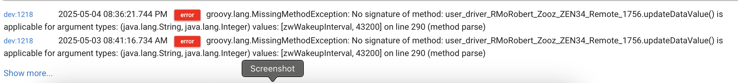

Got another error code.
No errors on any of the 3 other ZEN34's.

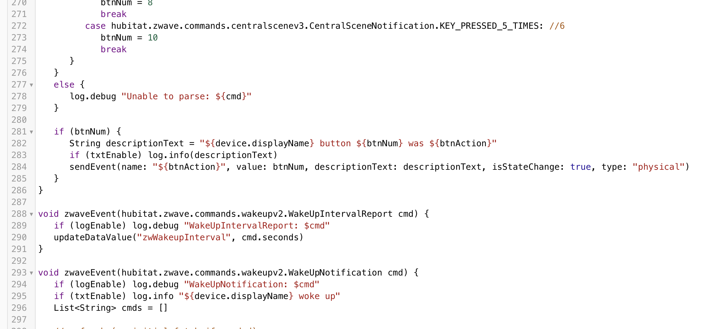

Looks like the same issue as earlier.
Yes. And only on the one device.
I just tested a ZEN34, and it still works with the new driver, so that's a plus!
Hmmm, might check that device and see if it is using the new driver (don't think that line 290 has the same code in the newer version).

What other error? That's the same one as your original screenshot, a couple days old now, and what the update made a couple months ago specifically fixes.
I am not aware of any problems with the current driver version (or any hardware changes to the device that should matter).
