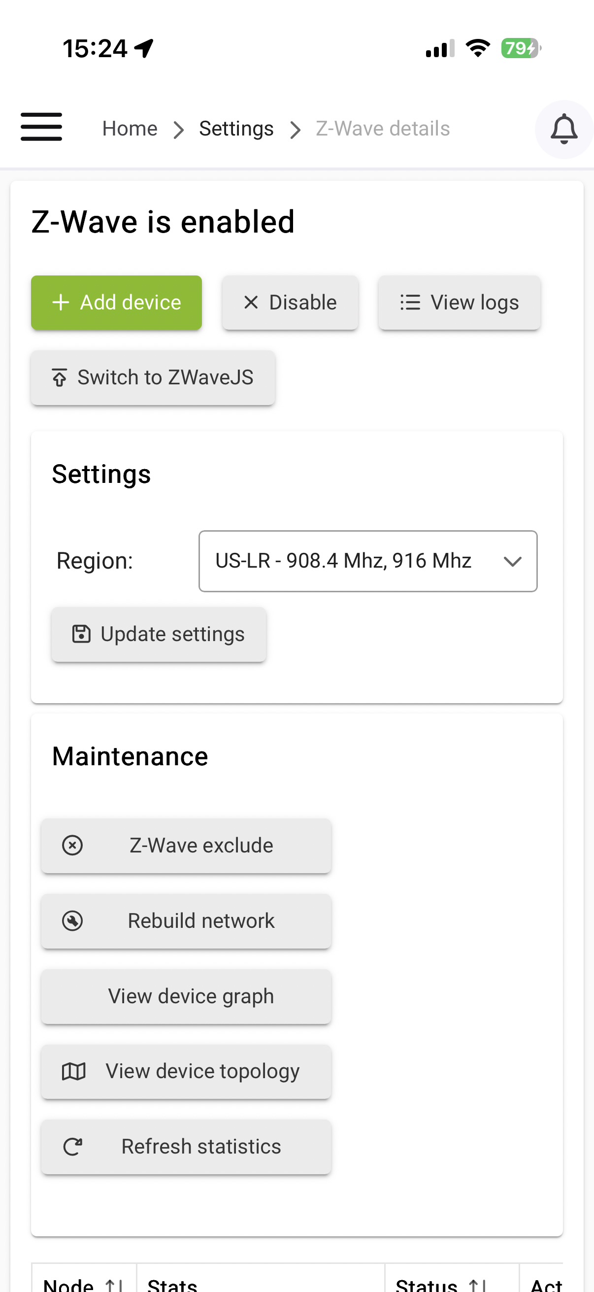

Sure. Can you help me find that? Is it just a filter applied to the devices page?

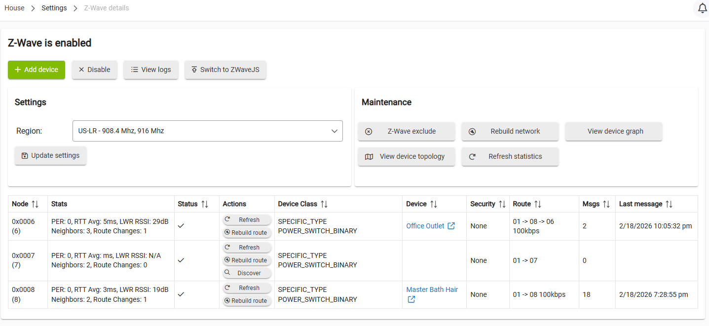

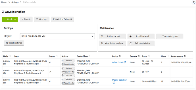

Found it, I think. Is this what you need?
Start here How to Build a Solid Z-Wave Mesh | Hubitat Documentation
number 7 is a ghost (improperly paired). Probably when you 1st tried to pair master bath hair. This will cause communications issues in the mesh. Any time you have a failed z-wave pairing you need to check for and remove ghosts. Click refresh on that line and then click remove. (might have to do it a few times) When removed, shutdown hub, unplug power for 1 minute then power back up and see how things behave.

Thank you. You are correct. It hung the first time I paired it. Didn't realize ghosts were a thing. Is that obvious to you because it has no device listed?
No.

Correct
