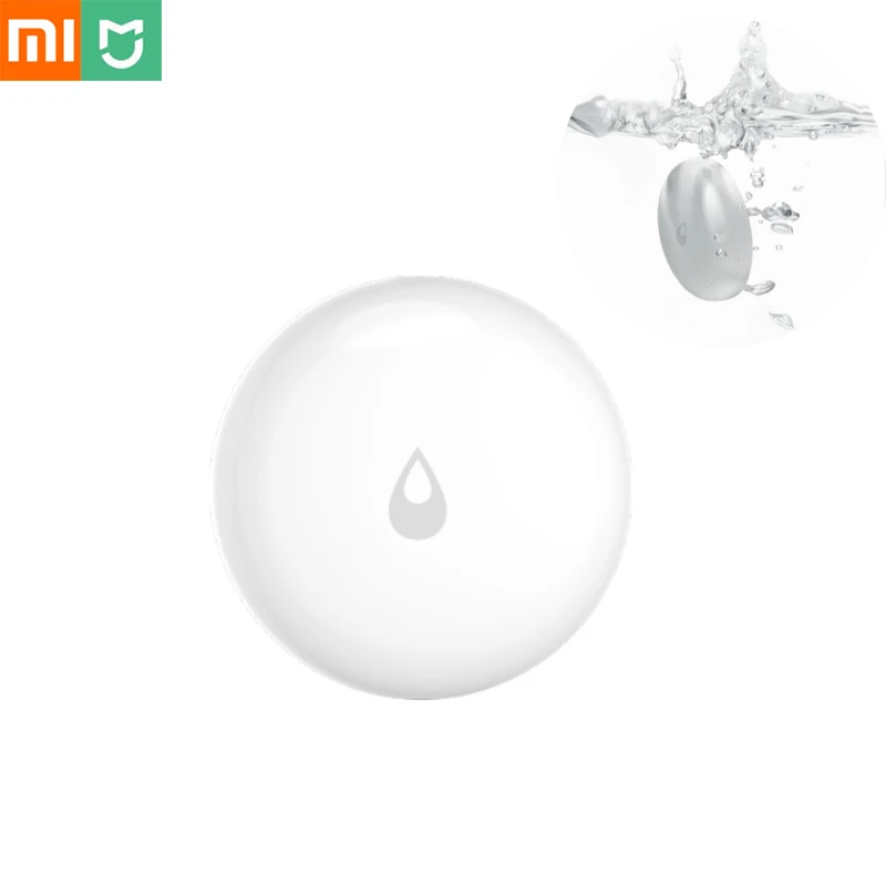

Cheapest ones that I've ever found are the Xiaomi sensors. However, it appears that you have to be just a bit more careful in their setup. I found that putting an Ikea Tradfri repeater on each floor of my house, was the ticket for correct repeating. Also, you have to use the community drivers that have been set up by @veeceeoh (who has done an amazing job).
Water leak sensors:
