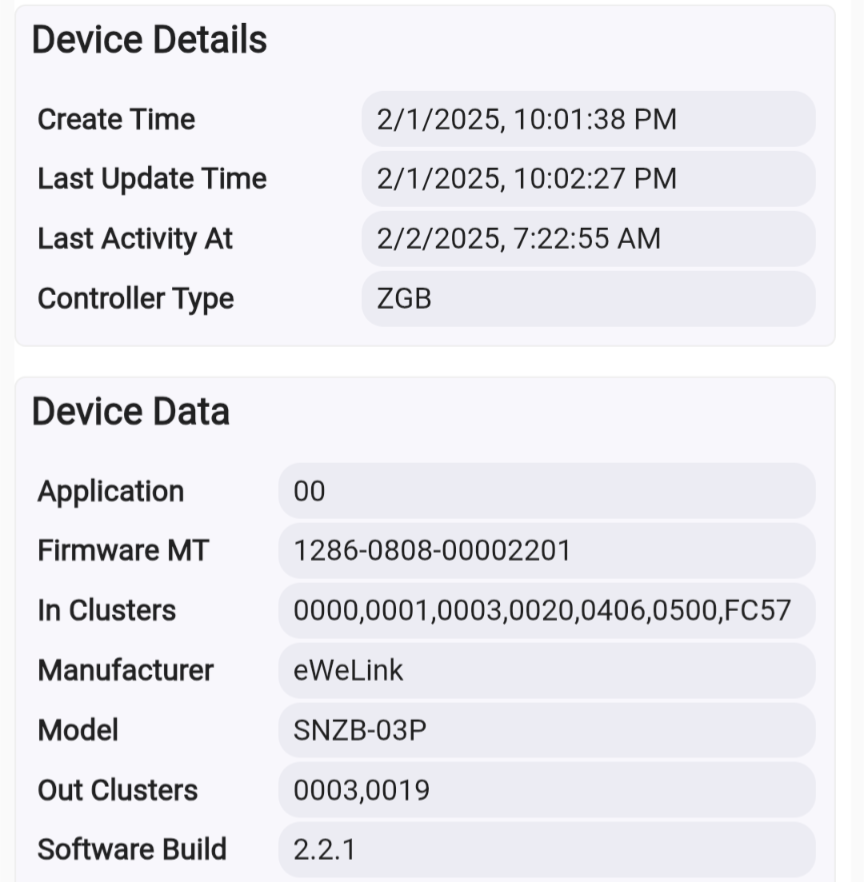

Data of one of the motion sensors:
  • endpointId: 01
  • application: 00
  • inClusters: 0000,0001,0003,0020,0406,0500,FC57
  • manufacturer: eWeLink
  • model: SNZB-03P
  • outClusters: 0003,0019
  • softwareBuild: 2.2.1

Looks like the new SNZB-03P does have different clusters to the old version too...
This means that the device is paired and the Zigbee connection is OK....

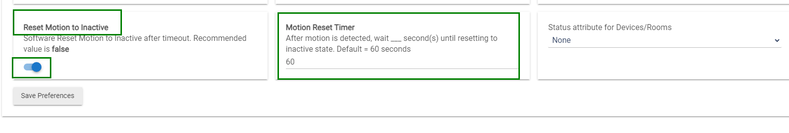

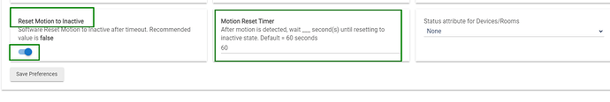

To enable the software reset timer in this driver, you must first toggle the 'Reset Motion To Inactive' switch in the Preferences section and click the Save Preferences button.
Then, you can modify the 'Motion Reset Timer' timeout.
Make sure you click on the Save Preferences button.

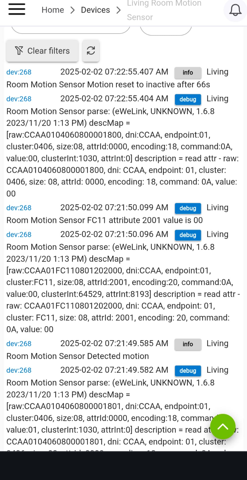

I've paired a Sonoff (eWeLink) SNZB-03P motion sensor, using the Tuya Multi Sensor 4-in-1 driver. From my State and Device data, see Sonoff (eWeLink) SNZB-03P motion sensor - doesn't reporting battery level? - #3 by John_Land
I've tried to set the reset time to 10 secs. That appears to work in the UI, with the UI indicating "inactive" after 10 seconds and the log saying "reset to inactive after 10s (software timeout)".
HOWEVER, the sensor does not ACTUALLY reset -- it will not re-trigger for up to 6 minutes after being "reset" to inactive by the driver.
Is this a problem with the driver, the sensor, or my configuration?
