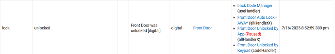

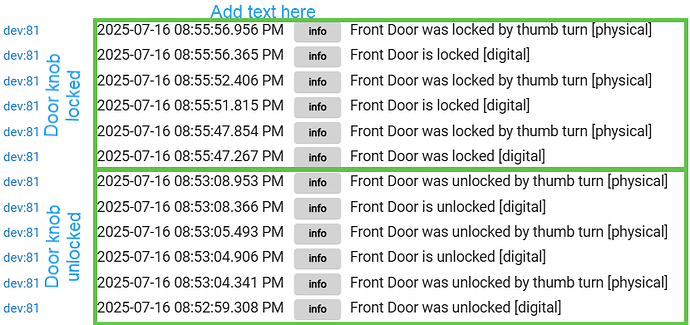

The issue that I have is related to the reporting of the manually unlocking of the lock. I am not generating a physical unlock event. Instead I get this event -> Front Door was unlocked [digital].
My expectation is --> Front Door was unlocked [physical] This is how my previous lock works.
However, if I look at the log, it shows the physical unlock and some other unexpected stuff.

Here is the event screenshot.

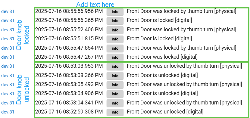

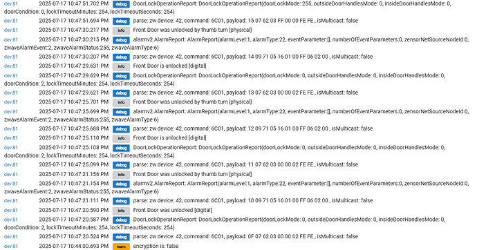

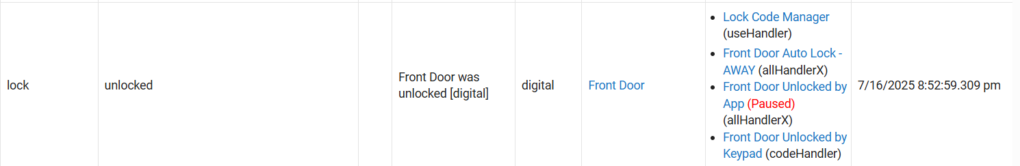

Yes, it shows in the log but it does not trigger an event. Below is the one entry in the event log. My observation is that there is an inconsistency between the log and the event. Is this the function of the driver?
Also note the duplicate entries in the log generated at the same time.

I tested both 1 knob turn unlock and 1 knob turn lock 2 minutes apart. Here is the log. The events show only a digital unlock and lock. My expectation is that the EVENT would be a [physical] unlock and lock.

The logs are a bit hard to follow because it's not clear what entries correspond to what real-world events and how many of them. But it would also be good to enable debug logging so you can see more about what the lock is actually reporting to the hub, not just what events things are getting parsed into; that would be the best clue as to whether there is any data to work with in the driver.

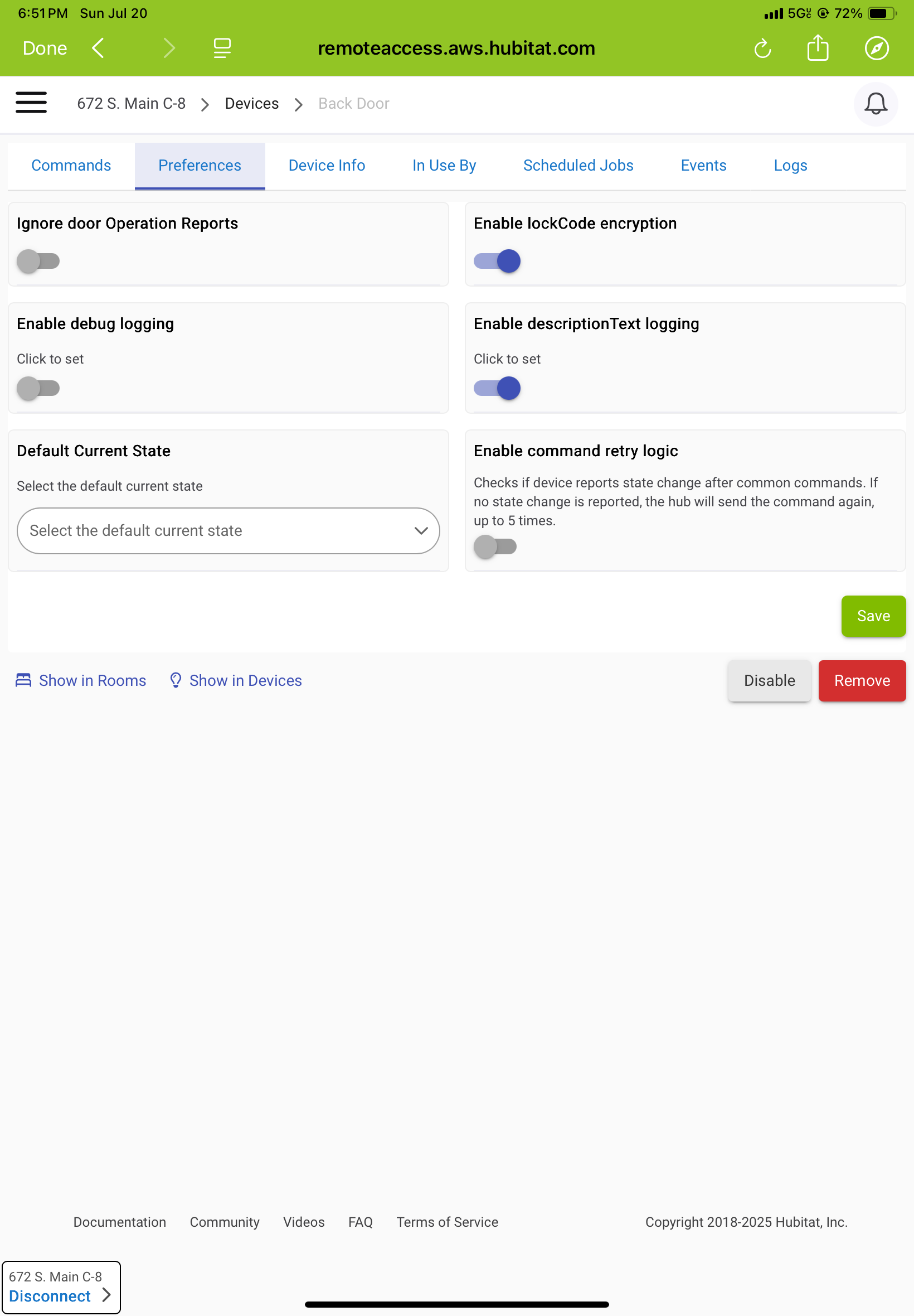

In addition to what @bertabcd1234 asked for (debug logs), is “command retry logic” enabled for this lock? If it is enabled, can you disable it - the logs in your first screenshot suggest it is enabled.
No, it is not enabled.

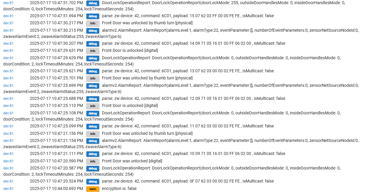

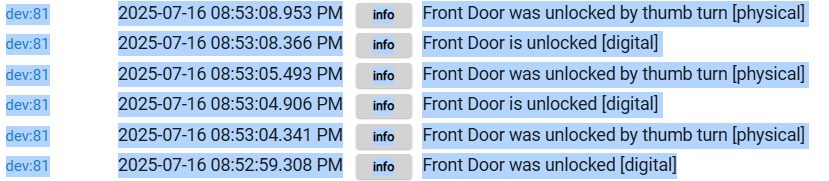

Here is the detailed log for the physical unlock.

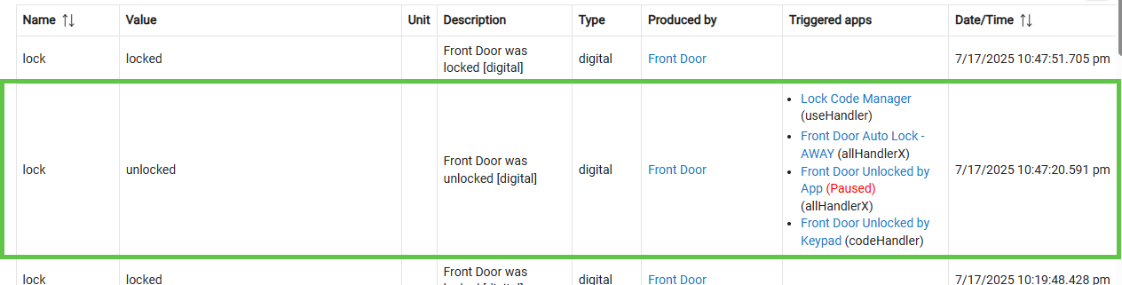

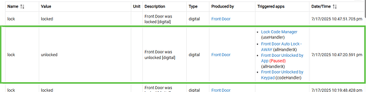

The event triggered for the unlock.

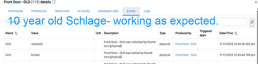

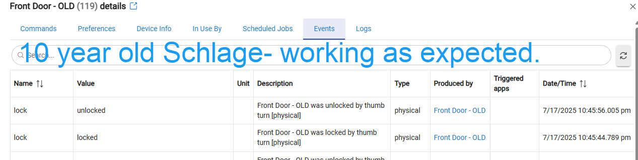

My 10 year old lock is still connected to the hub and works as expected.

OK, just to be sure what I'm looking at: a single physical unlock spawned 30+ seconds of log entries?

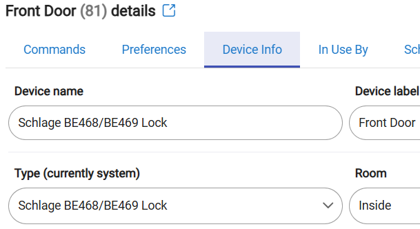

You might also want to compare the firmware versions of the two devices, likely under the Device Info tab in the Device Details table. Nothing you can do about it (older ones aren't upgradeable; not sure about the Plus models, or if they've ever released any even if it's technically capable), but it could explain some of the differences.
Not 30+ second. 10 seconds (10:47:20-10:47:30) with detailed logging on for just the unlock (once). The last entries are me locking it again. This lag was not seen in my unlock log posted previously, but now I noticed that the delay was present in the locking (same screenshot).
Interesting observation. How do we determine if the lock is sending multiple signals or Hubitat is? What is a payload number? That changes. These AlarmReports and Event Parameters are also of interest.
Yes, the firmwares are different. The other lock is 10 years old. The new is on firmware 0.11.0. Schlage support won't tell me the date associated with this, and I could not find anything on the internet.

The OLD lock shows the same AlarmReports and Event Parameters--only once; the events are also as expected.

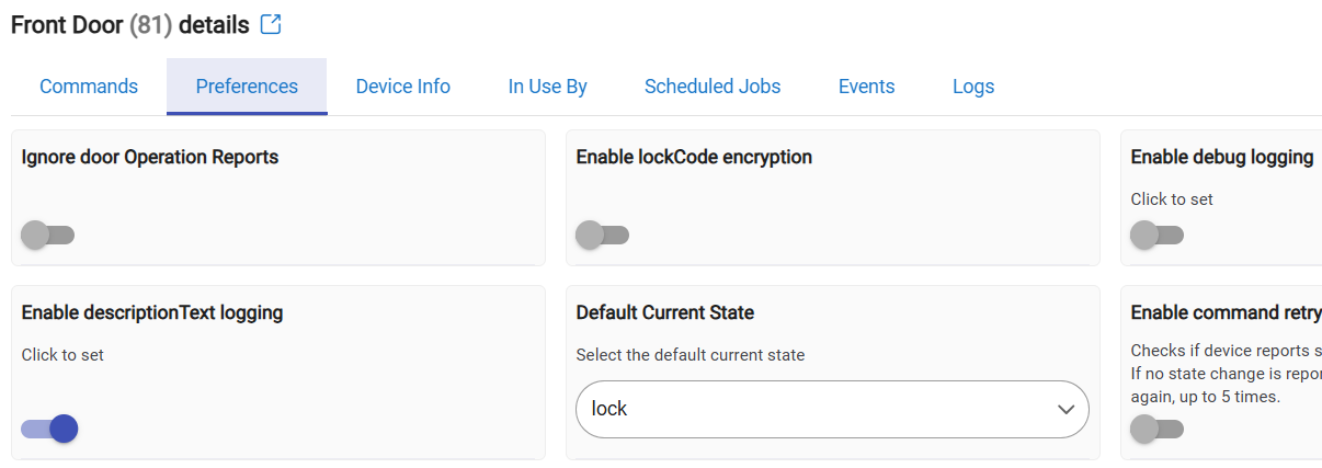

Looking into this driver a bit, there should be an "Ignore door operation reports" preference you can enable that will take care of some of the Z-Wave messages that appear to be a good chunk of the issue. Those will always get parsed as digital events, so if this is in response to a physical event as you say, it should eliminate that problem. (I don't remember exactly what this preference was added to address -- it was just added a couple years ago, not there originally -- but I imagine it was some issue like this and again suspect it's probably related to device firmware versions and resulting behavior differences.)
There are still a few seemingly duplicate AlarmReports, which based on your data are (correctly) getting parsed into the "unlocked by thumbturn (physical)" events. That's still odd, but it shouldn't cause any problems without the other events getting in the way, as the actual events are likely to be filtered out unless some app is specifically excluding that default behavior in its event subscription for any of your automations.
I might also rule out something on your hub: check "Events" and see if any of your apps are sending a "refresh" or additional commands in response to some other event that might cause this. The "In use by" section on the device detail page might also be useful to look at and get other ideas.
