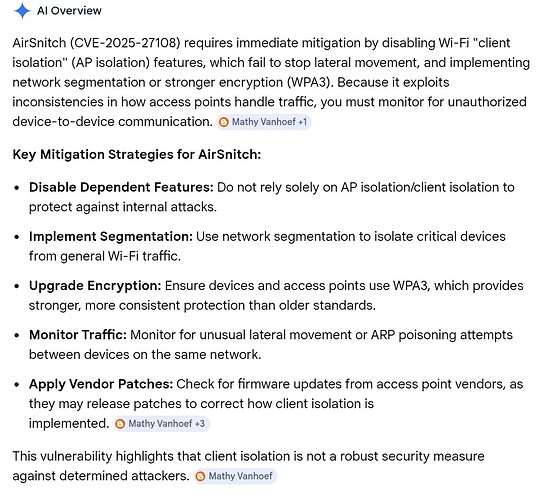

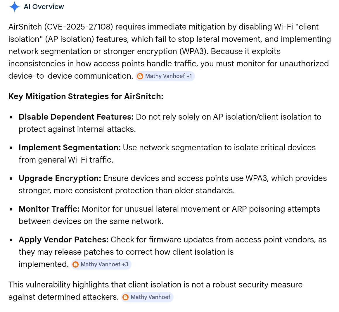

Here is what i got when i asked about mitigation. Not sure i would trust that CVE number though.
It seems to be heavily related to networking pricipcals vs Wifi, and a issues with how AP's handle MAC address validation.
I am still looking into it though. Allot of the conversation seems to be centered around the idea of a network using Client isolation as the tool for protection.

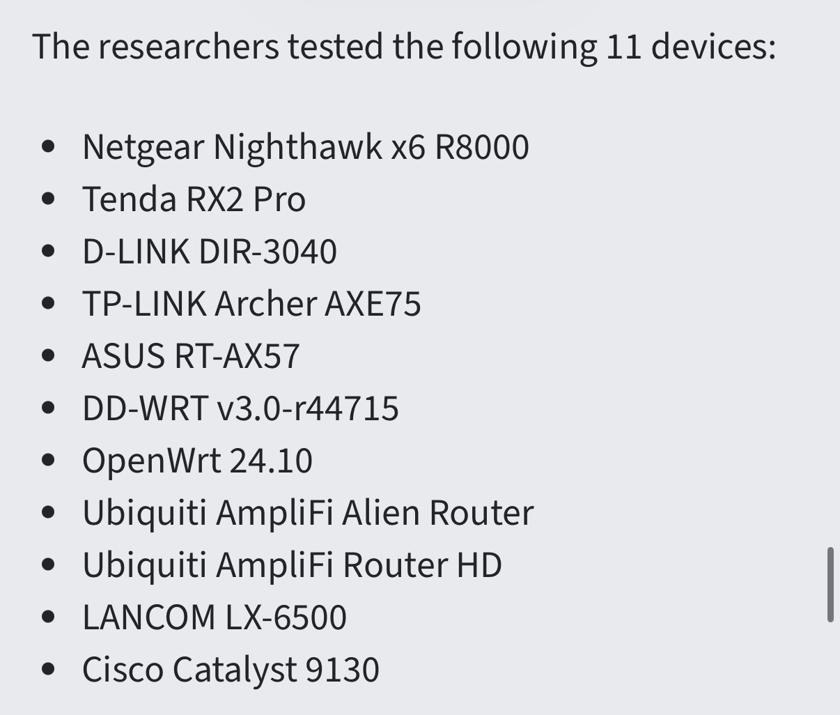

Well, their list of compromisable routers was:
No offense to the Amplifi line, but hasn’t ubiquiti really blown up in recent years because of Unifi?
Why didn’t they test against a unifi router?
Also, this is so very much not in my wheelhouse. But I know a little bit about the scientific method.
These guys published a paper. Is there a peer-review process for journals that cover this stuff? They made a presentation at a conference, presumably demonstrating the issue?
Do other experts also try to replicate their findings before the internet blows up with “WIFI IS FUCKED!!!”?
No, that was their list of tested routers. The implication was that since EVERY tested device was vulnerable to at least one of the methods, then ALL devices must be vulnerable.
We do not know their selection criteria, but a sample size of 11 out of all of the models available would make me skeptical of at least two things:
-Selective choices (aka cherry picking)
-inadquate variability to make a widespread claim
Typically, in a white paper, if one makes a list of tested items, they back it up with justification of why or how they picked what they picked. If this was peer reviewed, it would/should be flagged for that alone.
So, while I can see the issue, I am gonna go with what @danabw said also. It has to be on your network. If you are letting people on your home network that you don't trust, well you kinda get what you get. Enterprise solutions, I can see where that is an issue (yet I have yet to put my personal phone on ANY of my work networks and I don't put my work phone on my home network). I rarely use public wifi (I carry a hotspot with a VPN back to my home network), and if I DO get on a public network, I use a VPN.
Not saying this isn't a security issue. Just saying that there are lots of asssumptions made for a sample size n=11, which is well below what I would use for a valid sample size in my line of work.

And confirmed did not request/create CVEs (and why):
We don't have a CVE number. Whether devices/networks are affected also highly depends on the specific configuration of the device/network. This means that some might interpret some of the identified weaknesses as software flaws, but other weaknesses can also be seen as configuration issues. That's actually what makes some of our findings hard to 'fix': it's easy to say that someone else is responsible for properly ensuring client isolation :slight_smile: Hence also hard to really assign CVE(s).
One of the main takeaway issues, in my view, is that it's just hard to correctly deploy client isolation in more complex networks. I think it can be done using modern hardware, but it's very tedious. We didn't test with VLAN separation, but using that can definitely help. Enterprise devices also require a high amount of expertise, meaning we might have missed some specialised settings.. So I'd recommend testing your Wi-Fi network, and then see which settings or routing configurations to change: GitHub - vanhoefm/airsnitch
