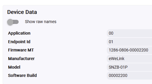

I just bought a SNZB-01P and connected it to my C-8 as a Sonoff Zigbee Button Controller. Single and double presses work fine, but the events log shows long presses are interpreted as single presses. @kkossev, I also tried your Tyua Scene Switch TS004F driver, but (after re-pairing the device in place without removing it from the hub) it exhibits the same issue. Any thoughts, anyone?
  • Application: 00
  • Endpoint Id: 01
  • Firmware MT: 1286-0806-00002200
  • Manufacturer: eWeLink
  • Model: SNZB-01P
  • Software Build: 00002200
I don't know if it will work but there is a Third Reality Smart Button driver you can try. It is worth a shot.
You may have a defective device then. I'm having no issues using the "Tuya Scene Switch TS004F" driver.
