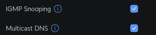

In the network application, make sure that Multicast DNS is turned on. I have IGMP Snooping also turned on, but I'm not certain it is necessary.
Screenshot 2025-05-09 at 10.14.50 PM
Multicast is checked. I was wondering about IGMP snooping ..

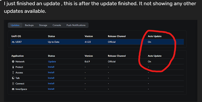

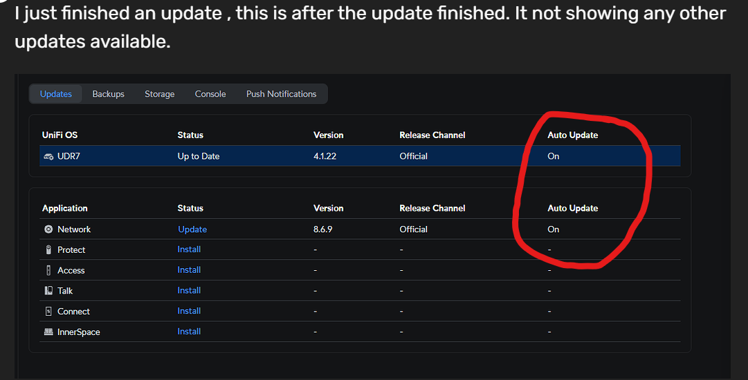

I recommened DISABLING the Automatic updates of both the UDR7 and Network App software. Ubiquiti is pretty good about putting out good code, but every once in a while, there is an issue for some users. Waking up to a broken home network, and wondering what happened, is never a good feeling. Especially if people in the house depend on the network to work from home.
Good idea, fixed!

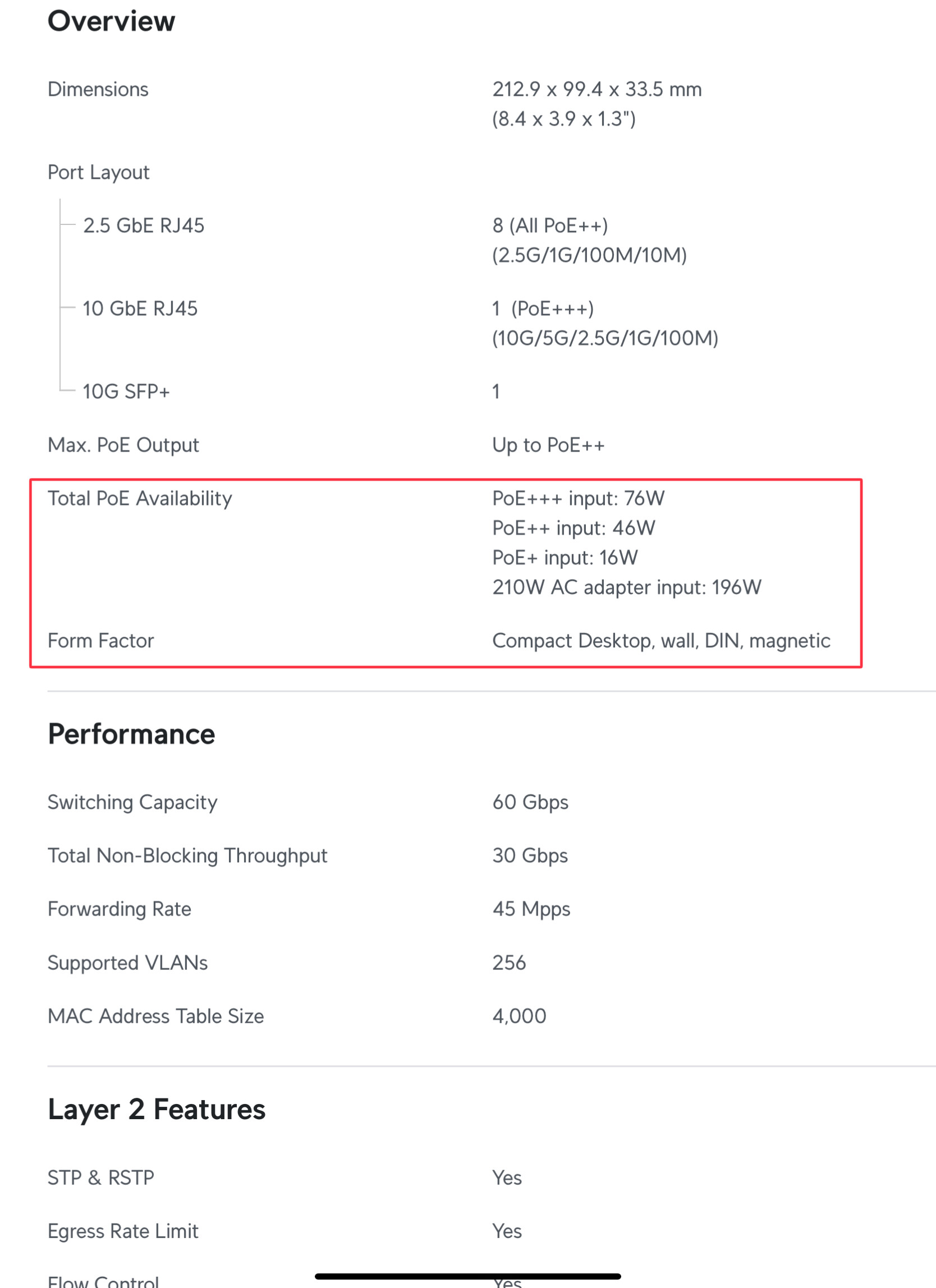

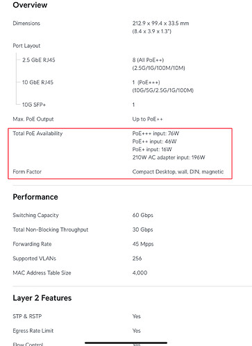

Correct, the UDR7's 1 PoE port is only standard PoE and the Flex 2.5 requires PoE+++ which most Unifi routers currently don't even support. Crazy that the power supply is a separate purchase but once you install it should be good to go.
The Flex 2.5 PoE can be powered by PoE+++, PoE++, or PoE+. The maximum PoE output is a function of the power supply.
Sorry but have to disagree, your screenshot is for outputs, unless I am misreading their hardware specs
The table show the maximum Total PoE Power output based on how the switch is provided with input power.
I am powering one of these switches using PoE++, with no issues whatsoever.
Hum then I find the list confusing given a separate spec for power method.
I still believe the underpowered UDR7 might be causing the issue for @lcw731 given it has a single PoE (not PoE+) port (unlike the UDR6) and only has 15.4W.
I totally agree that the UDR 7’s single “PoE” port cannot power the Flex 2.5G PoE switch. The minimum appears to be at least PoE+.
I also agree that the documentation is a little confusing. :sunglasses:
