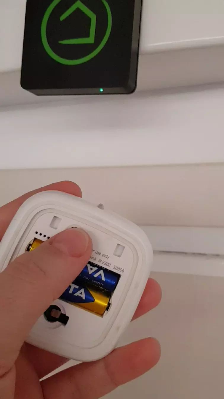

By 'really close' I mean something like this
