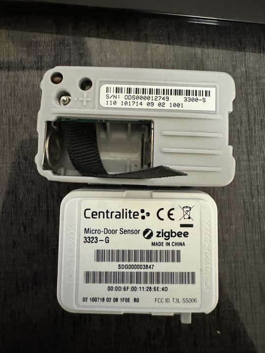

I have these:
both are centralite units

well, these are not the uniฤŸts ฤฑ have issue with. both contact sensors I have are using Cr2450 battery
And I only have issues with contact sensors. Not leak sensors...
OP never clearly said so, but heโ€™s probably trying to use a centralite 3321-S, aka 2015 ST multipurpose sensor.
don't have one of those, didn't even know centralite made a multi, i only have the 2017 model
