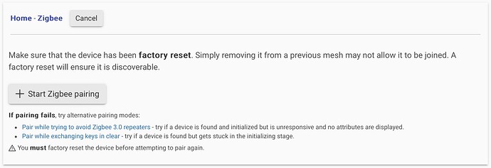

The Zigbee radio/chip in the C8 is 3.0 and there have been some oddities when pairing some older (non-3.0) devices. Lots of posts on a few different devices (I remember the Hue outdoor motion sensors being a hot topic at one point). Have you tried using the "Pair while exchanging keys in clear" as mentioned on the Zigbee add page and factory resetting the sensor before pairing to the C-8?
Tnaks for your suggestion. I tried that option.
But I could not try factory resetting the device. Because I don't know how to factory reset Smartthings contact sensor. I can't find instructions. Do you have any info ?

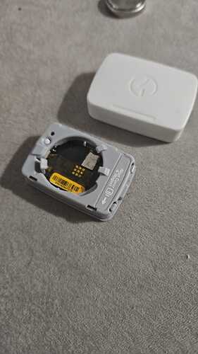

it says "smartsense multi" on the back

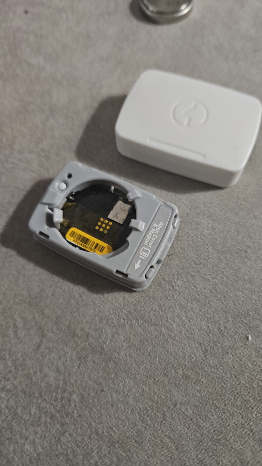

If you open it there should be a model number on the board

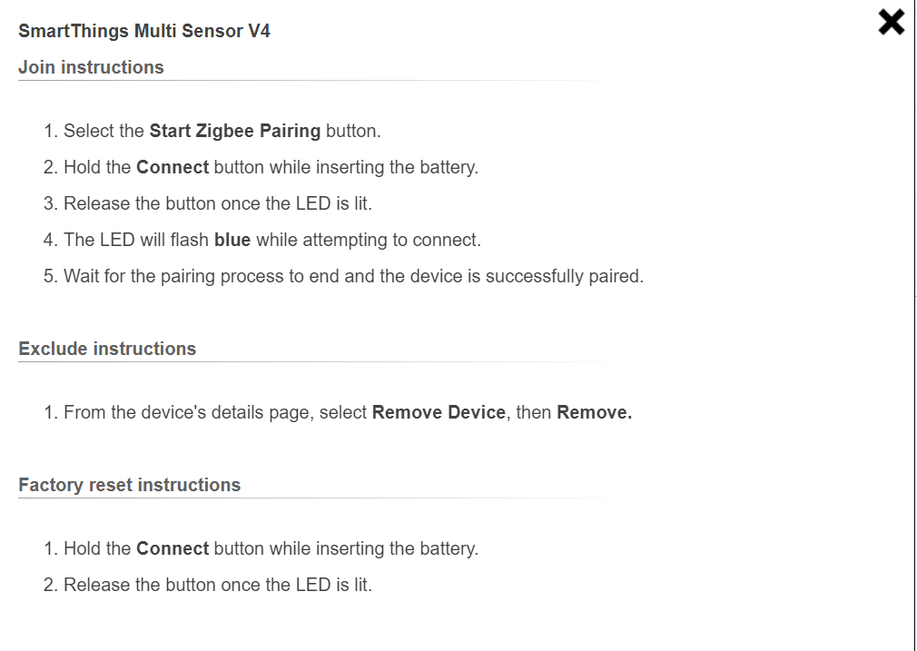

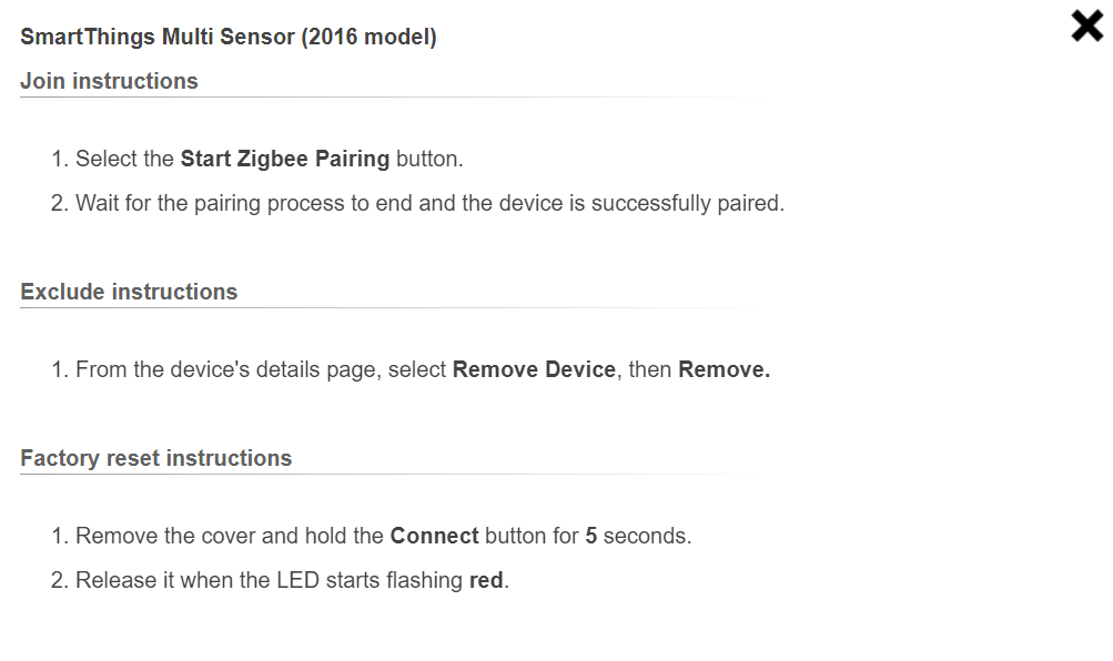

Is it this one? Also completely turn off your c4 and don't bring it back up. It can cause issues with pairing. Set the c8 zigbee channel to 25 and your wifi on your router to 6 or below.
https://venustitan-guidance.readthedocs.io/en/latest/_static/src/door_sensor/smartsense_multi_doorWindow_sensor.html
I've set my channel to 18. If I change it now, shall I have to rejoin all zigbee devices again ?
no not that one.

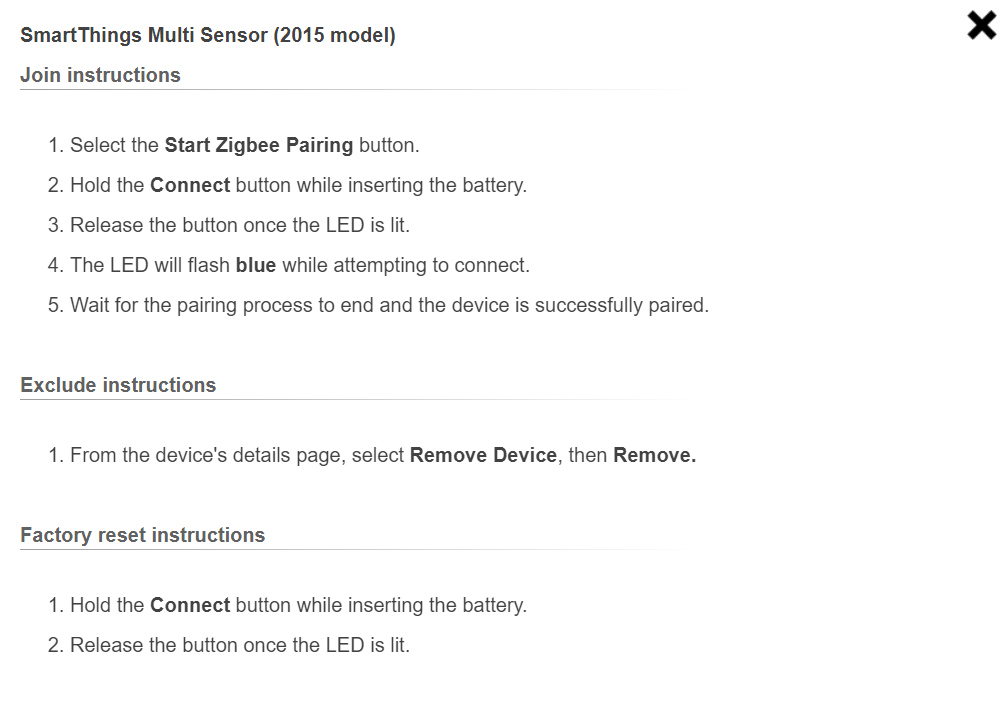

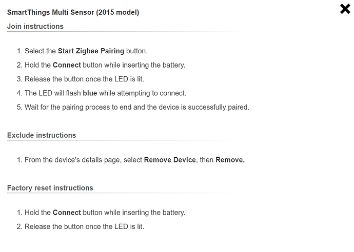

That might be a v4. I have one that looks similar - I think it's a v4. Here are the instructions for the v4.

According to the instructions shared above , factory reset is same as joining. So it is already factory reset.
That is correct (and seems to be the case with many Zigbee devices).
