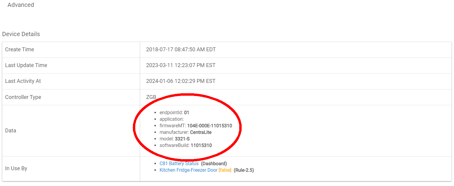

I would think we would want to see the information from the device page - here is one of mine:

  • endpointId: 01
  • application:
  • firmwareMT: 104E-000E-1F075310
  • manufacturer: CentraLite
  • model: 3321-S
  • softwareBuild: 1F075310
Looks the same as mine except for the 1F07 instead of 1101. I would guess that means yours is a newer release.
