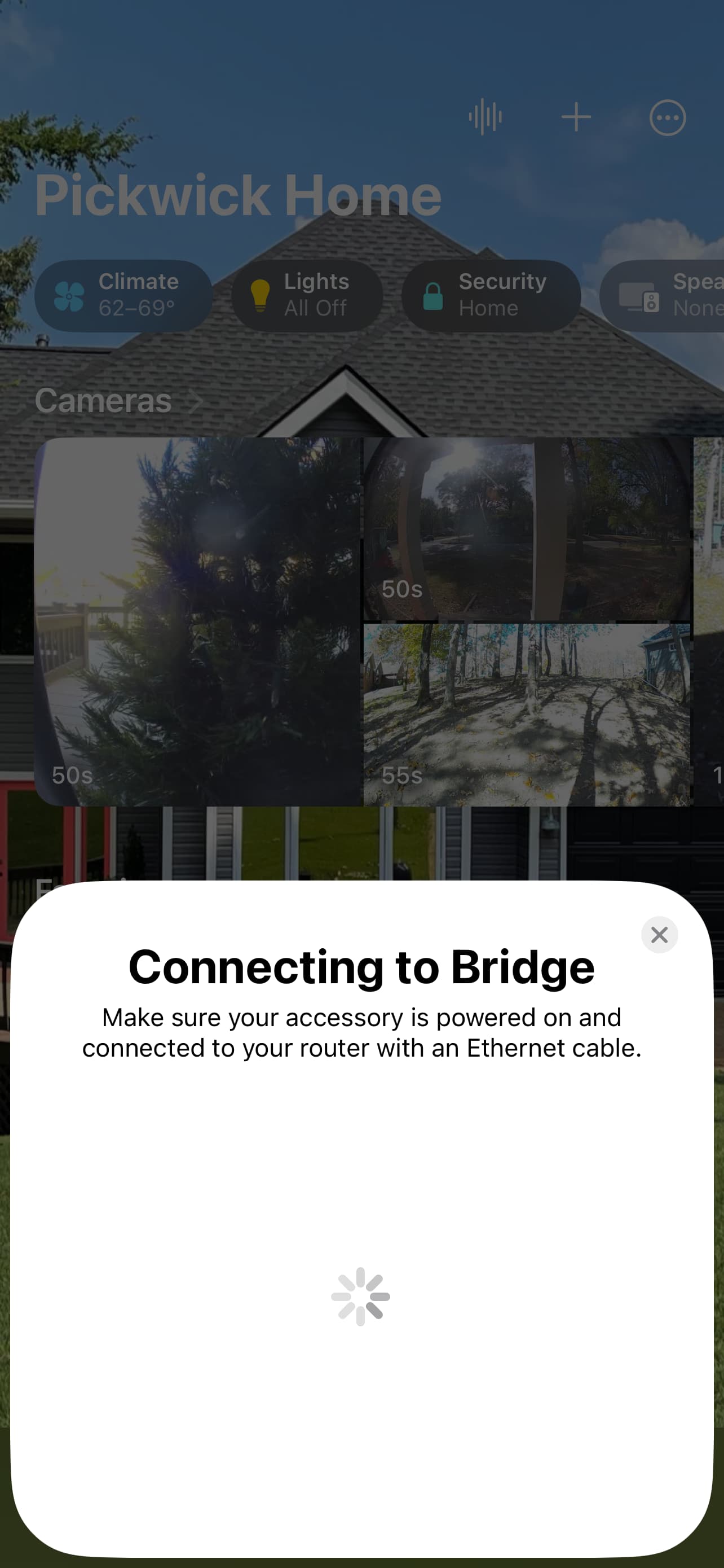

Wondering if anyone has been able to add the HE hub to Apple Home via remote access. I’m traveling for the Thanksgiving holiday and not patient enough to wait until I’m back home late Sunday
I’ve been using Apple home for a while, have a 2021 AppleTV 4k and a HomePod Mini and can acces that environment remotely. I’m able to connect to the HE hub remotely and enable the new integration, but consistently get the messages below when adding the HE hub.
