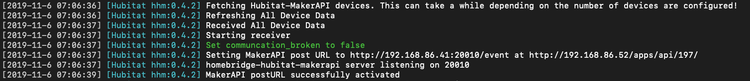

Here is more output from the initializing of homebridge as well

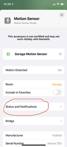

HomeKit Notifications

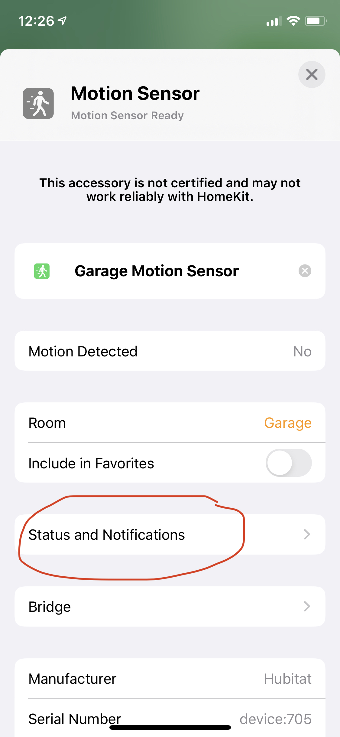

Notifications are setup in the Home app, inside an accessory's detail view. If the accessory supports it, there will be a submenu labelled "Status and Notifications."

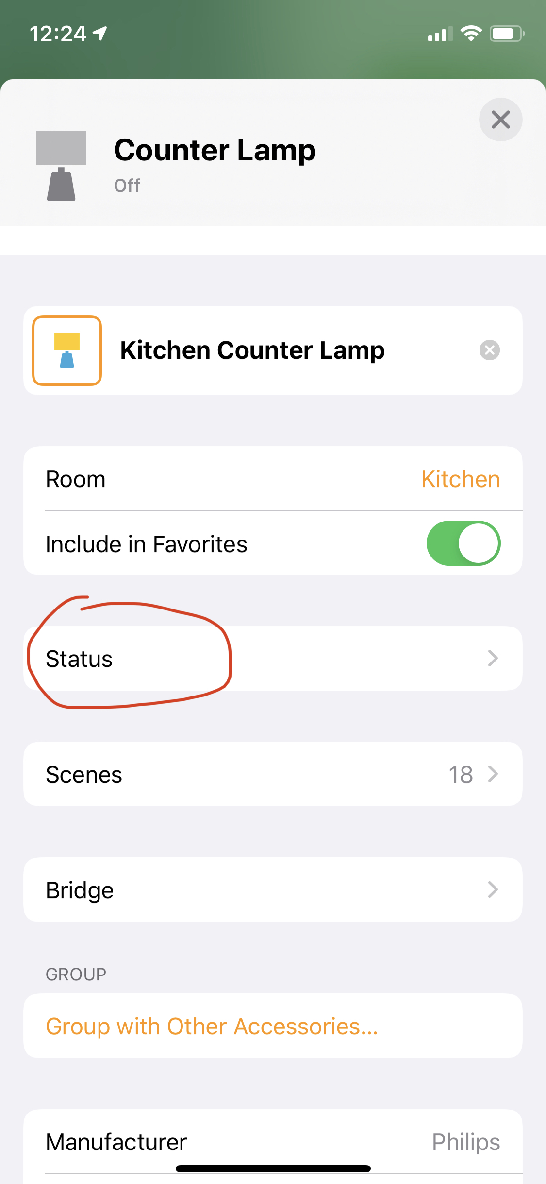

If the accessory doesn't support HomeKit notifications, that submenu is labelled simply "Status" and lacks the notification options.

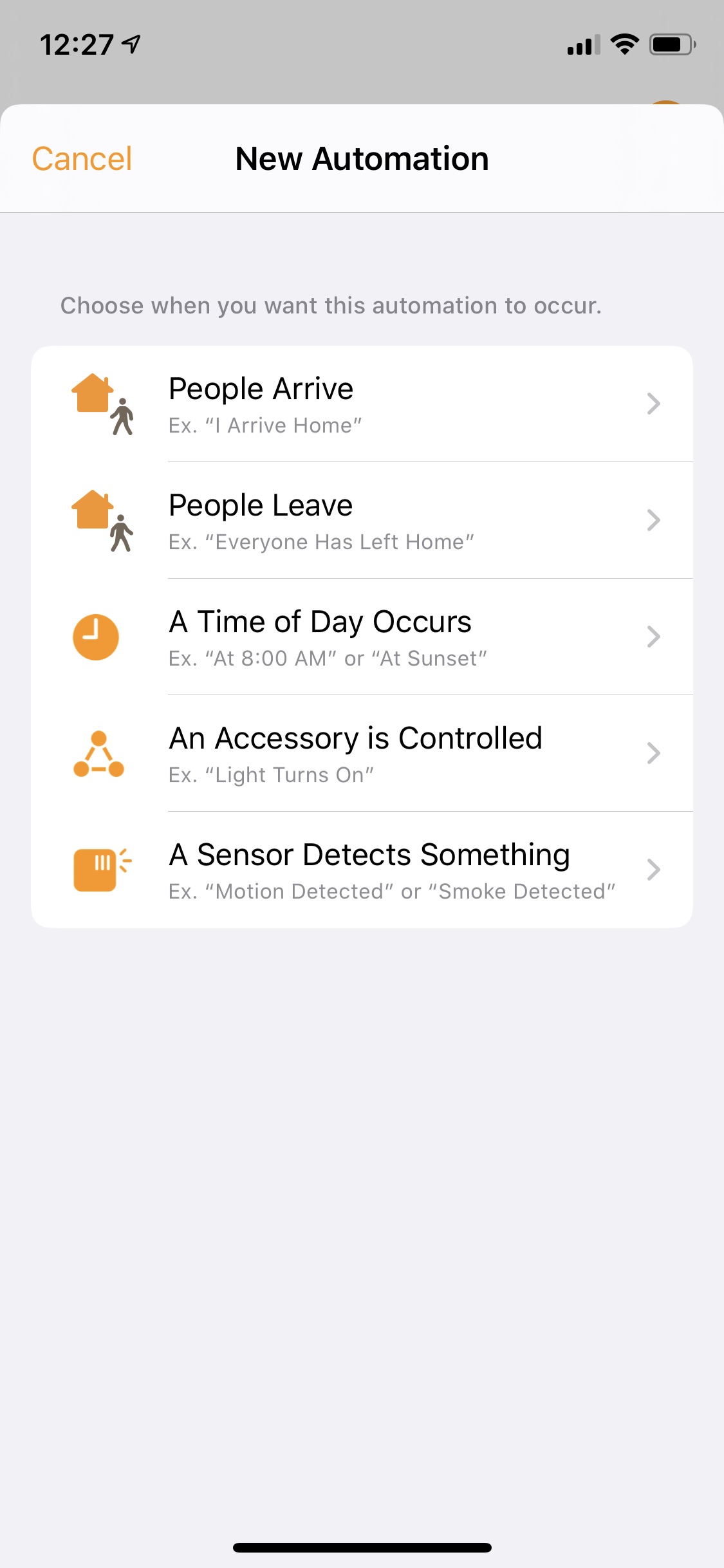

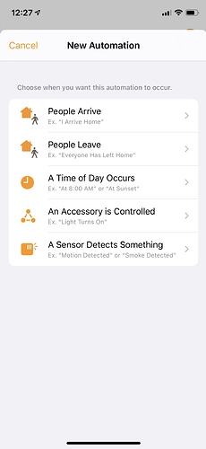

HomeKit Automations

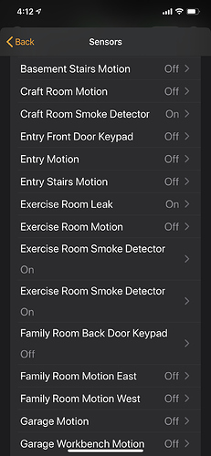

As far as I know, all HomeKit accessories support triggering automations based on state change. You set these up in the Automation tab of the Home app. If the accessory you want to use as a trigger is the sensor type, choose "A Sensor Detects Something." Otherwise, choose "An Accessory is Controlled."

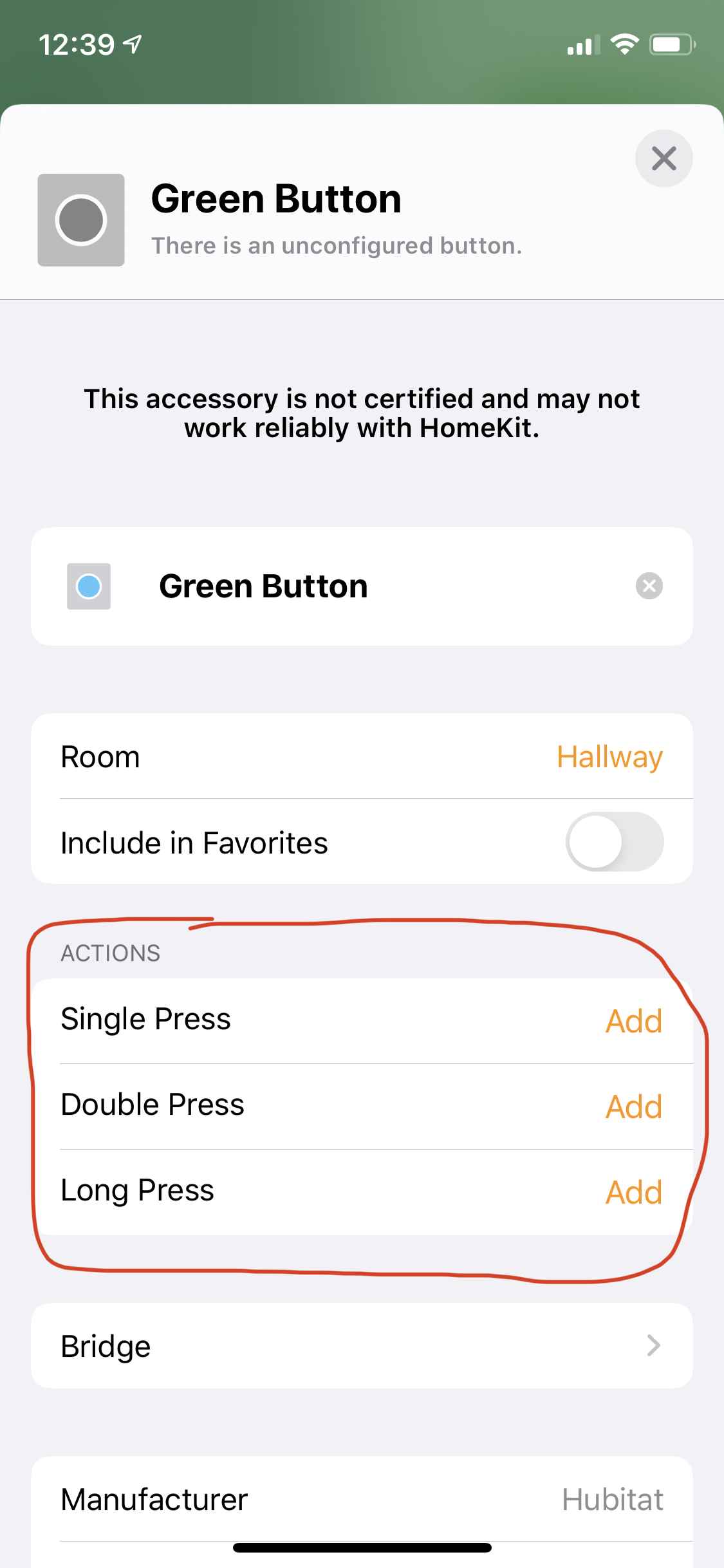

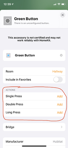

The only exception to this I'm aware of is the "programmable switch" type: those triggers are set inside the accessory's detail view.

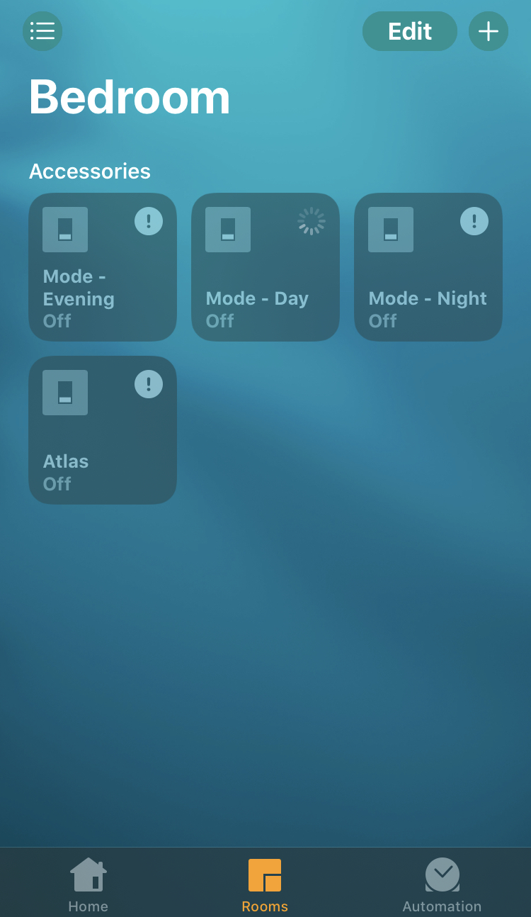

Thanks! That seems to work! I only have one lamp configured with Homebridge just to see how it works and the Homekit app gives me the lamp itself (Atlas) along with modes. Is there a way to remove the modes? Does this have to do with something in the config file or something from the way it's setup in Hubitat or something like that?
Your can remove Modes by settings mode_switches to false in your config file (or deleting the entry completely)

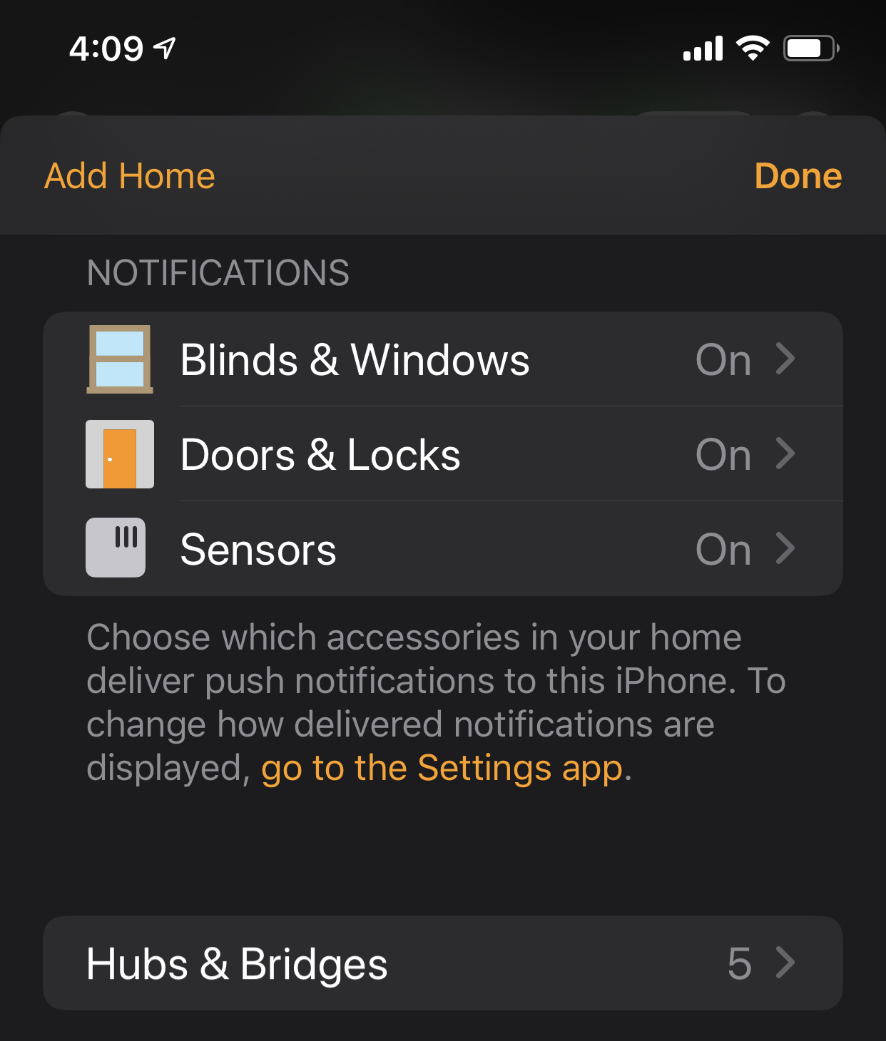

In iOS 13 the notification configuration has changed. To configure notifications go into the home settings and expand the notification type.
