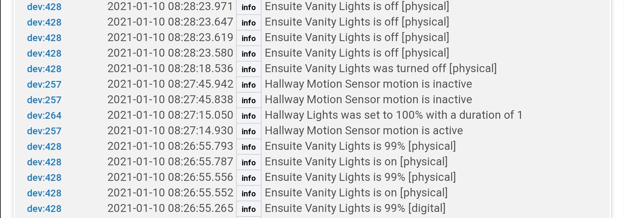

Ok thanks. I'm still getting dozens of log entries for my leviton switches on the generic smart dimmer drivers and was hoping this driver would fix that.
Doesn't sound right, even for the generic driver, can you post a screen shot example for just one device?
This is a recent one although only several duplicate entries, not dozens like I sometimes see.
Here's another switch, not a dimmer like above, doing the same:
One more for good meassure
All Leviton switches/dimmers updated to firmware 1.2
These drivers can be modified to not display duplicate description text to some extent, or you can turn that off in the driver, but this problem is not driver related.
In one case above I see the device sending an off state event 7 times in under one second, this can only be a mesh issue such that the device is not receiving the ack from the hub, so it sends it again, this is further supported by the fact that the count of duplicate events isn't always the same.
