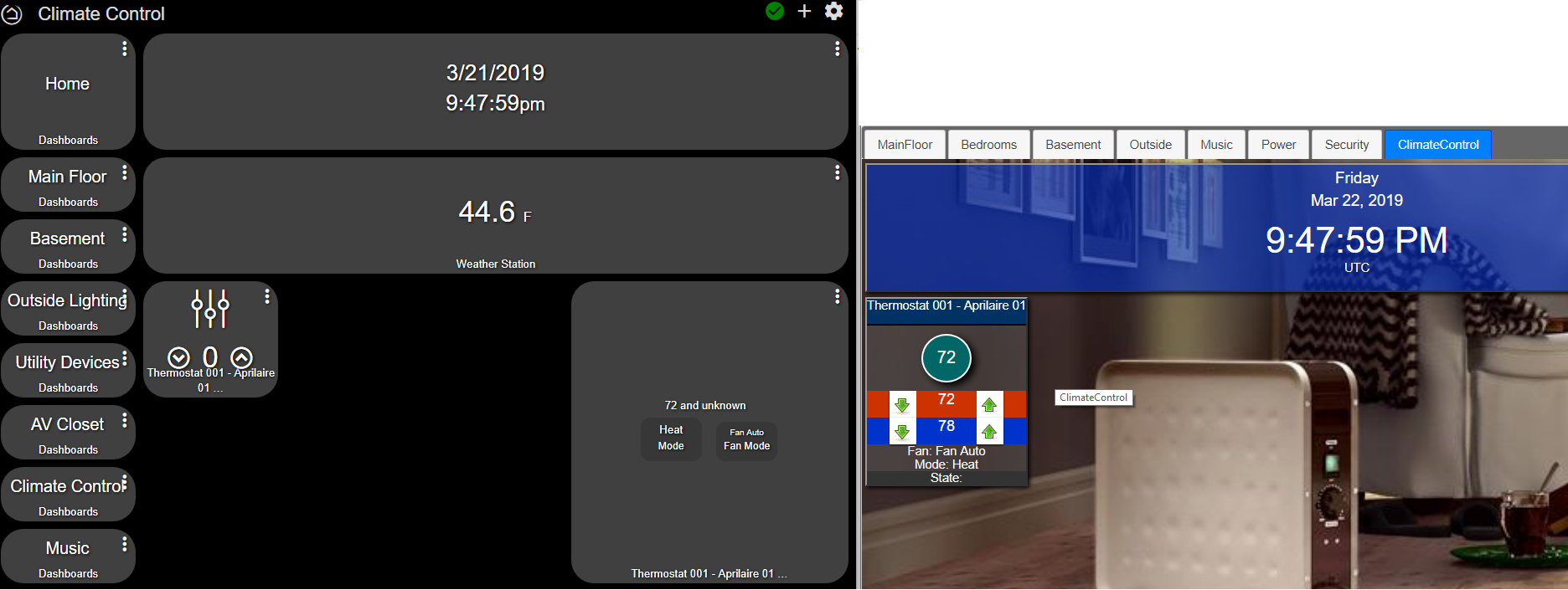

Here is a view with the new virtual thermostat on the left. So apparently that one is not displaying it either. I did notice in device page that I am not defining a thermostat Setpoint. Also, on a separate note my system does't communicate operating state. Thanks for your help!

@csteele - Thank you so much for your suggestions!
I had a case sensitive issue in my driver. Here is the new tile (by the way not sure why it turned red in the middle of my fixing things):
Cheers
Mike
I see it changed to red cause my operating state is now working, NICE!!!
