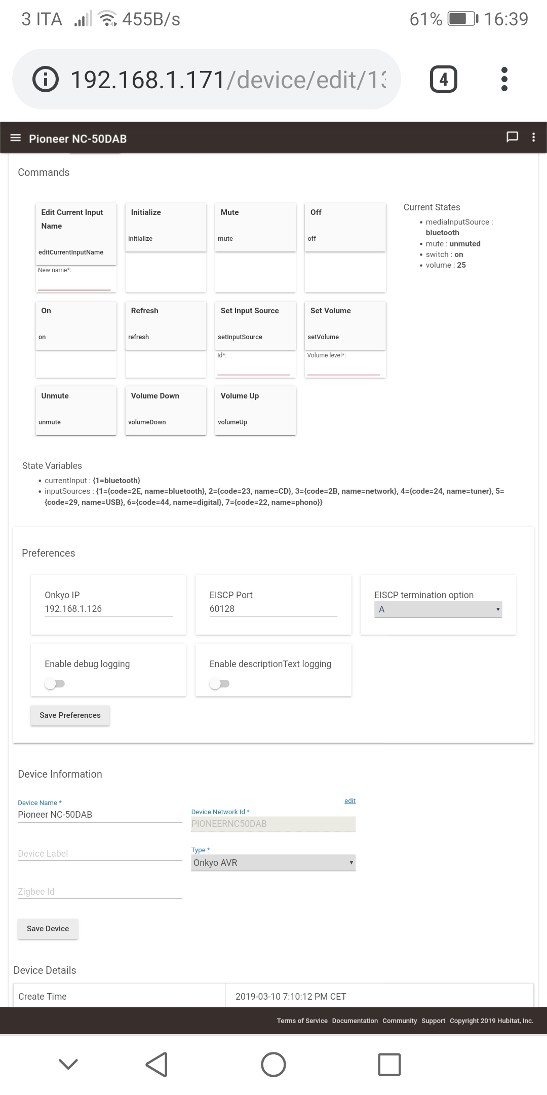

I'm using the Onkyo driver on my Pioneer nc-50dab (it seems many new Pioneer devices does'nt work otherwise) . Everything is ok in the app panel. I can modify volume set, switch it on/off and so on. Unfortunately in the dashboard the volume slider does'nt work. Is the tile supposed to act also as switch (on/off)?
Does the device details for the driver have a volume attribute?
Also no, the volume tile is just for volume. You can always try the dimmer template and see if that controls it.

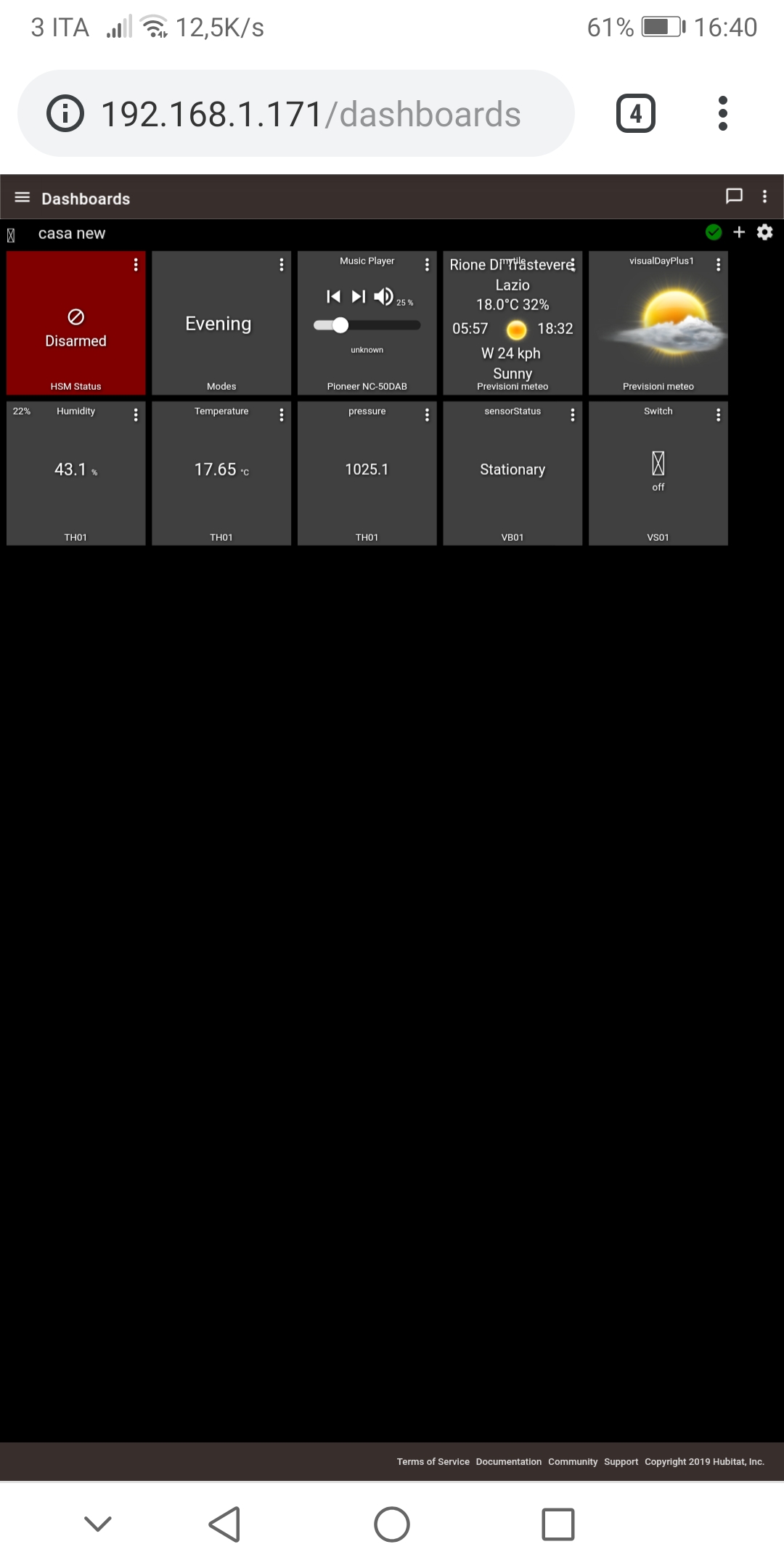

The template is Music Player and the device has attribute volume. The volume level text is correct. The slider seems not to change it correctly.
@patrick any advice about the (volume?) slider in the Music Player Tile?
Haven't had a chance to look at it. Are you running the latest? This is posted in an old thread referencing 2.0.7...
Does the volume tile template work?
No, it (volume tile) does'nt. It works only inside he device panel : volume up/down, set value. If I try to use volume both in volume tile or music player tile the device switch off (this is new since the 2.0.7)…
