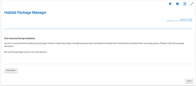

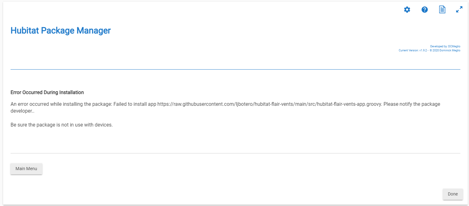

I am having some trouble installing this app (I had it previously installed, but ran into some errors, and I decided to remove it all and start from scratch.)
When trying to install from HPM, I can find the app, but as it installs it, it errors out:

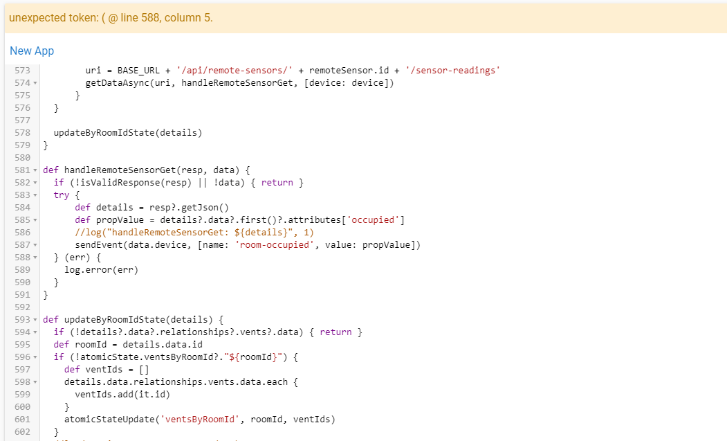

If I try and install the app code manually via Github copy/paste, I get an error when trying to save it:
Anyone else experiencing this?
I missed checking something in. Please try again, should be good now

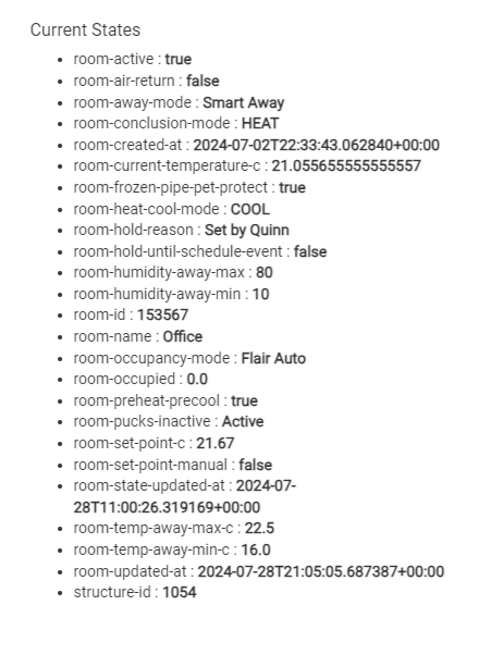

I got the app installed and devices discovered, but now I can't seem to control the vents themselves. I am not seeing a 'percent-open' state listed in the vent devices (i believe I saw that state in previous driver versions), and when I try and use the Set Level command to change the vent, the physical vent never changes...
EDIT: Now that I'm looking closer, it looks like the vent device in Hubitat is possibly missing a bunch of states that are supposed to be there (percent-open, rssi, duct-pressure, system-voltage, etc.) and only has states pertaining to the room, not the vent:
P.S. Thanks for all your hard work on this; very grateful!
Are you able to control your vents from the Flair app? Trying to help narrow it down…

EDIT; Noticed also if create a clean new instance of the app on my development hub, I don’t get percent-open either. Same as @quinnjudge.
Yep, vents open/close as expected from both the Flair website as well as their phone app.
I went ahead and installed from scratch, I found open-percentage was erroing the first time was set. I fixed that. As far as the vents being changed while disabled, I did not find anything apparent from a closed box analysis. I'll do some testing and see if I can replicate that behavior.
update: I found some other issues that are now fixed. Latest version 0.14 should be fully functional based on the end to end testing results I've got, including all problems reported above. BTW, the very first time the app is run, all vents will be in 100% open including any disabled ones, this is because the app needs to collect some stats in order to calculate the flow and rate of cooling/heating for each individual vent.
I can confirm that, after removing and adding the latest version from scratch, I am now able to open and close vents from within the Hubitat device - thanks!
FYI - the 'percent-open' and 'level' states never appeared on their own inside the Hubitat device page (I left it alone for a full day); only when I issued a Set Level command did the state populate in the Current States list. Is this expected? Also, none of the other device-specific states are appearing in the list (rssi, voltage, etc.)
