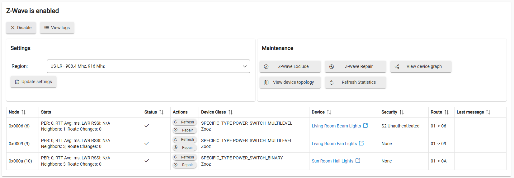

New C8-Pro failing to reliably join
I am configuring a new Z-wave network with a C8-Pro. I had a C7 that just stopped working. I had all sorts of issues so I decided it would be best to just start over. I should note that I am attempting to exclude the devices from the old network and have do soft resets on the actual switches.
When I include a device I will get the text asking me about security, but then it doesn't do anything. If I reboot the hub it will show up in my zwave table, but not my devices. On one device I was able to "Refresh" and then it showed up in my devices, but the 2nd one won't even do that. It also required a reboot to just appear in the zwave table. My logs seem pretty crazy for for a network with 2 devices. Any thoughtghts

Have you tried the radio reset routine where you power down the hub, then unplug it for 30+ seconds, and then restart?
It is a good thing to try if you have not tried that yet.
Please read the pinned READ FIRST post, especially the zwave section and regarding power supplies. Please provide the info requested in that post.
Please use screenshots to post logs.
Same issue. Paired all my switches then one lock. 2nd lock never finished pairing now the entire z wave network doesn't work.
Start a new thread and do as I said above.
You can tag me if you want.
Yes, it did help add another device, but now still dealing with issues adding a 4th.
The hub is powered by the OEM brick connected to 120VAC,
Don’t see any issues.
The zwave busy error basically means you need to just do a shut down and unplug.
Something i would say is be patient. Most of the time when i have triggered a problem and gotten errors with zwave busy it was because i was rushing. Do one task at a Time and let it complete. You may also want to go into the diag page and just do a reset of the zwave radio if it has been misbehaving already. Last thing i would suggest is when possible use Smartstart. I really think it has come a long way in usability. Also anytime you look at security settinga don't change them leave everything with the default values they start with.
