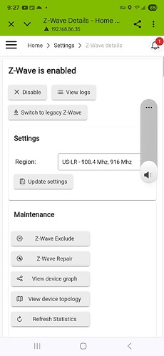

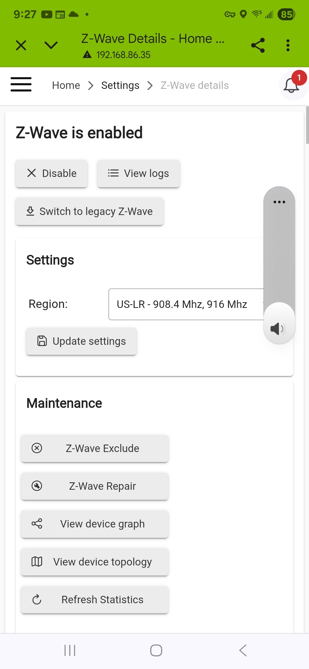

The zwave details page should look something like this on the top. This is on my phone. A tablet or desktop may have the spacing differet, but the stuff displayes should be the same. If i scrolled down you would see my devices.

Do you have the option shown in the screenshot to "Switch to legacy Z-Wave"

Yes, I have that option. (Legacy)
