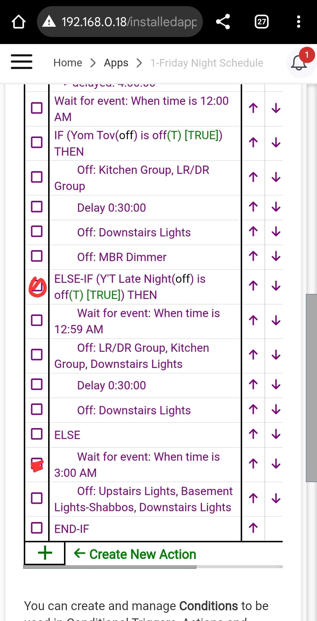

Trying to make this nested IF rule work. For some reason though even if the "Late Night" switch is on it is turning off the lights at 1:00 a.m. and not waiting until 3:00 a.m. as intended. Am I missing something in this rule structure? (There is a longer rule before this but this is where the IFs start)

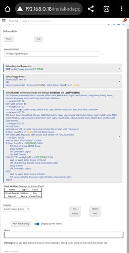

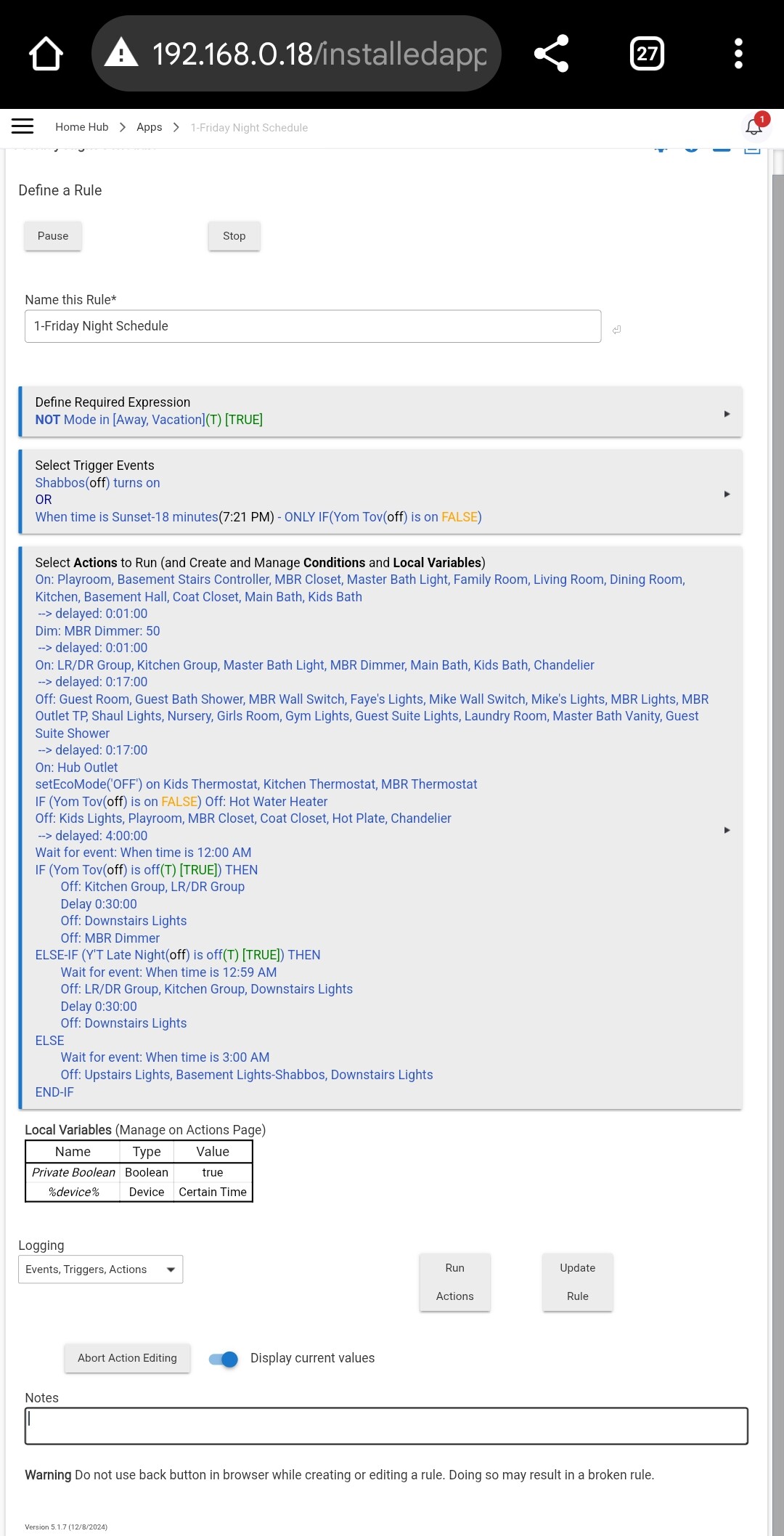

I think posting the entire rule build would be best to get the full picture (no pun intended), and a screenshot from a non-phone device would additionally be great - trying to parse anything from a phone screenshot makes it harder to follow.

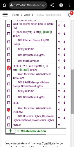

Is this better?
This is what it should be doing, At 12 AM midnight:
  1. should run only if Yom Tov is off
  2. Yom Tov would need to be ON (due to else-if) and Also Y'T Late Night would need to be off. Then wait for 12:59AM and run actions.
  3. Fall back, if Yom Tov is ON and Y'T Late Night is also ON, wait for 3AM and run actions.
Is that your intention?
In your example you said Y'T Late Night was on, but was Yom Tov also ON at midnight?

I think found the problem though. Late night switch is toggled by a Google calendar entry from a public calendar. It was looking at the event description instead of the event title for the keyword. Glad I sorted that out and that my IFs are working as intended.
