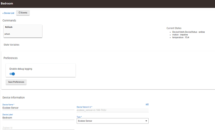

I've installed the ecobee integration and it created a device for the ecobee remote. It reports movement and temperature.
Of course it needs to go to the ecobee thermostat then to the ecobee cloud then to the Hubitat integration App. So when the ecobee cloud is down you loose the connection.
