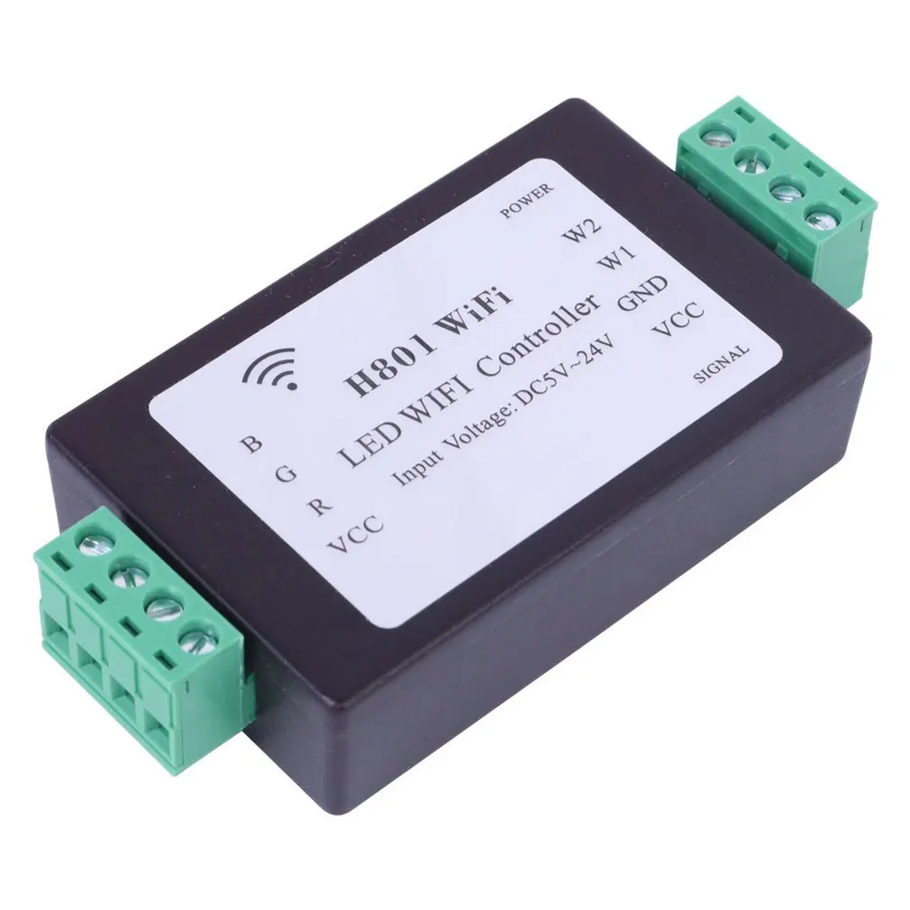

In any event for alternatives looks at the very inexpensive H801 LED controller and the firmware written by Eric Maycock. Controller is about 8-10 USD and LED strips you can get very cheap from even Amazon. H801 is wifi but very reliable, and has some cool color sequences you can customize
