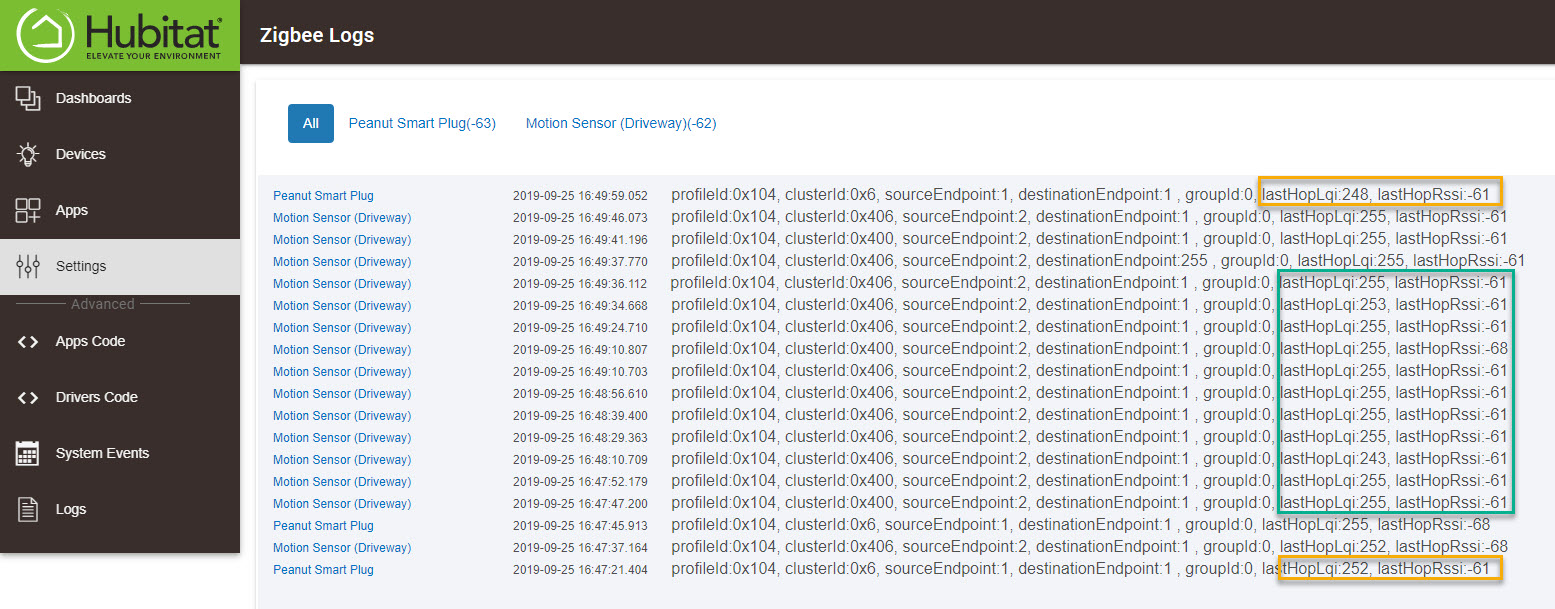

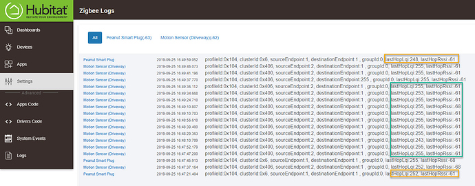

The good news! After I received the Peanut plug, my signal is now much better (I believe :wink: )
Here is what I'm getting now. Notice the Peanut plug has the same signal.
