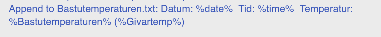

As @michael.l.nelson said, it’s easy to use the built in local file system and then access the file in File Manager in Settings. I log a temperature to a text file and it works great.
