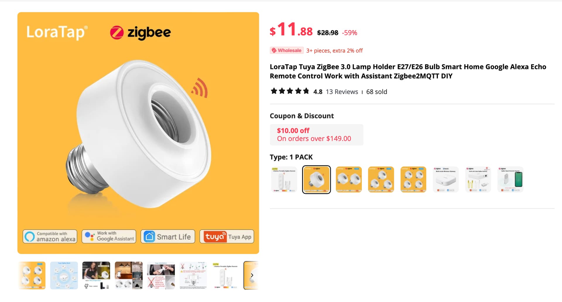

As an alternative to using a Hubitat-controlled relay in the fixture, you could also use a regular floodlight bulb with something like this ...
Been using one for a few months in the basement. Would work outside if it was protected from the elements.
https://a.aliexpress.com/_msqkJAc
