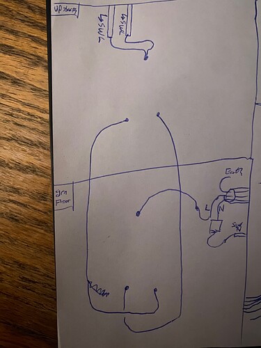

As best I can figure out how the lighting works is as follows.
Switch A gets power from consumer board / main leg of lighting daisy chain. It feeds this power into com.
Switch A has S1 and S2 running to switch B.
Switch A has a switching neutral returning to it from the light.
Switch B has the S1 and S2 entering from switch A.
Switch B has two switched live wires running out from com. (1 to the 5 lights, and 1 to the single light)

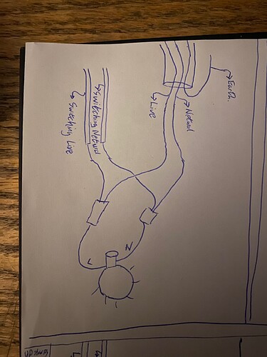

1st of the 5 lights has a switched live (feed from switch B)
1st of the 5 lights has a switched neutral returning to switch A
The 1st of the 5 lights has a live, neutral, and earth feeding onto the remainder of the 5 lights in a row

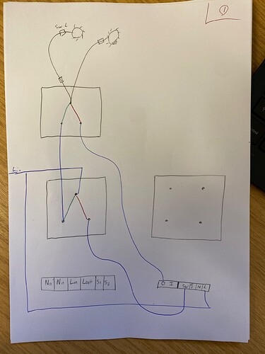

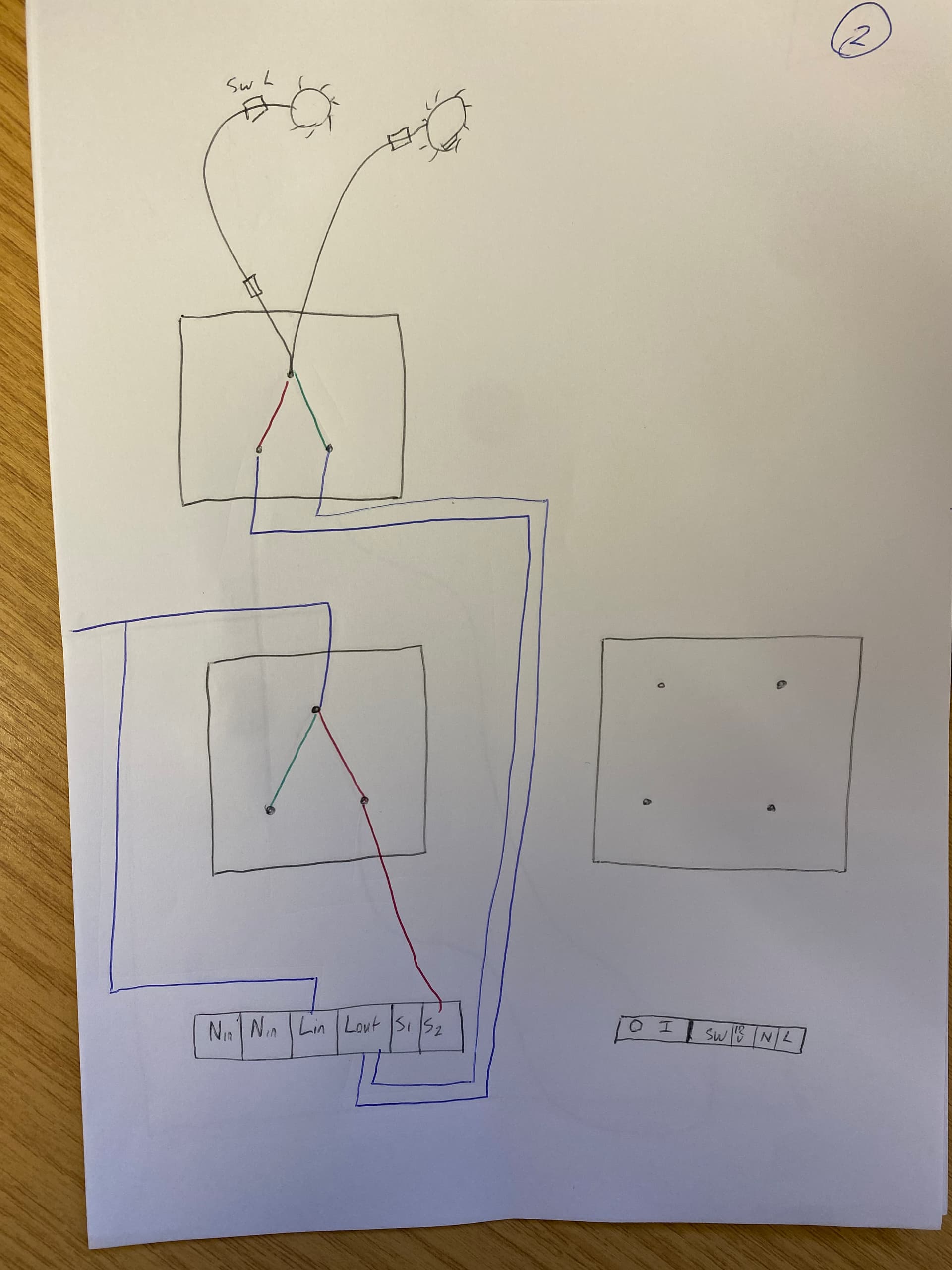

To answer my own question for anyone looking in the future I figured out a way to make this work with my shelly plus 1, but wasn't able to figure out how to do it with my sonoff zbmini (preferred device to use).
I'll post both devices if anyone could suggest changes to my zbmini to make it work I'd appreciate it.
Shelly plus 1 (working).
Sonoff zbmini (not working)
