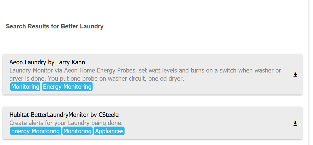

Search Hubitat Package Manager for Better Laundry Monitor. I think you'll find that is exactly what you are looking for.

Ok got Package Manager installed. When trying to install Hubitat Package Manager for Better Laundry Monitor it fails. Something is wrong with the Groovy.
