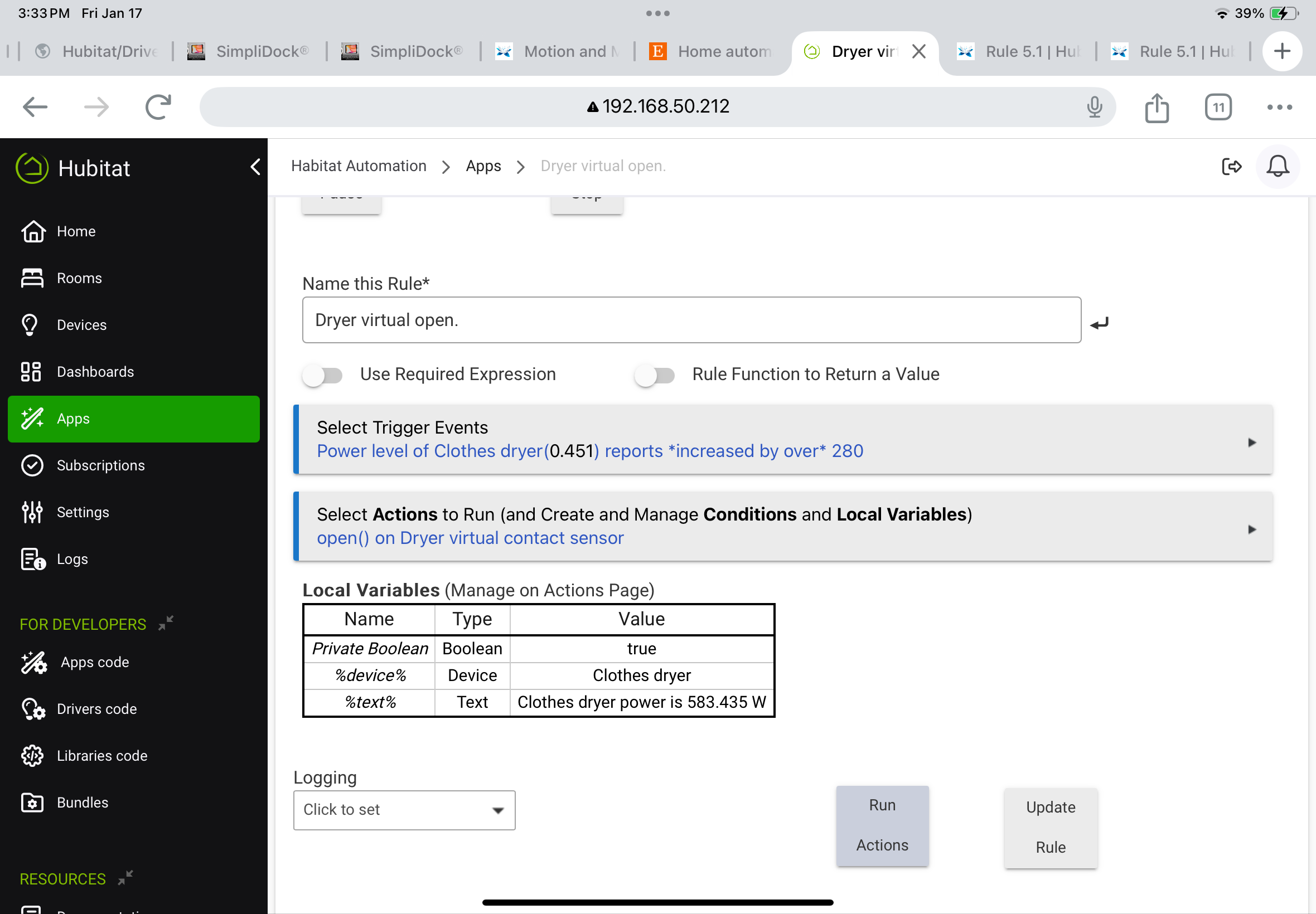

OK, so this is what I have if will open the sensor but then close it right away

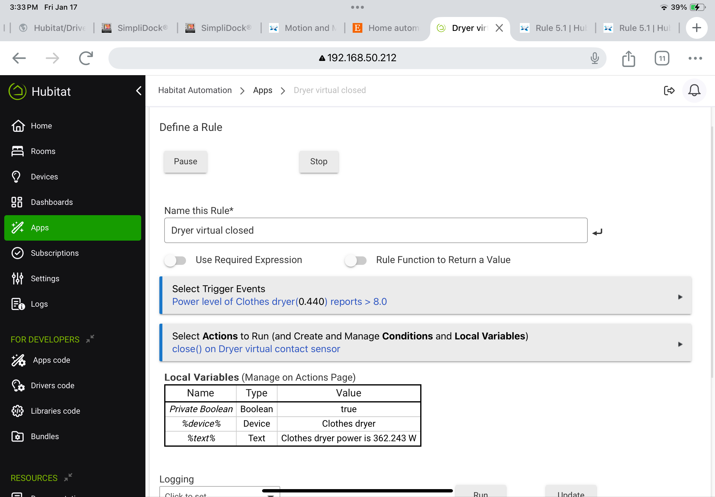

That makes sense by looking at your triggers. The contact opens if the power level increases by over 280. The contact closes if the power level is greater than 8. 280 is greater than 8. I think the contact closing should be less than 8?
Yes for some reason when i start the dryer it goes to open then it immediately goes to closed . However there is no way the watts could be less then 8 . So im confused
I would try using just your 1st rule and add a wait for event. After that add open contact when dryer reports less than 1.
Sorry im so new at rule machine , no idea what alot of this means .
That's not what your trigger says. The trigger is saying the Watt value is > than 8. You need to switch it around so that the trigger is Watt value is < 8.
OMG i feel so stupid :sob: :laughing:
That worked .. now its working fine thank you !!!

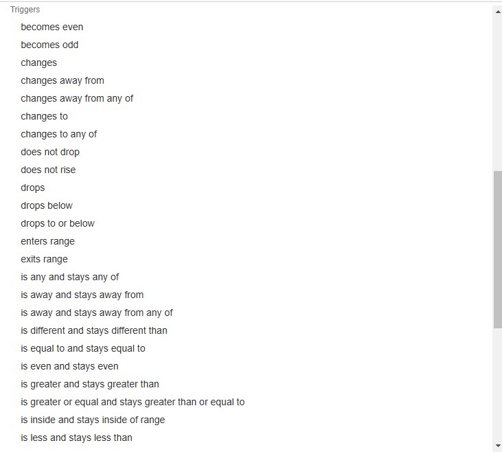

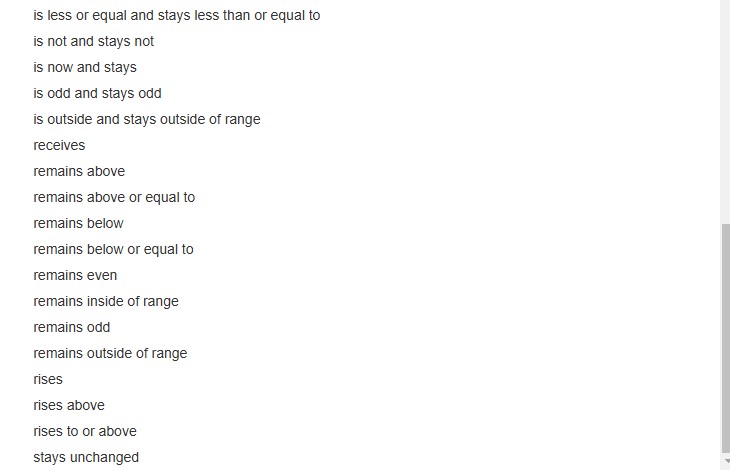

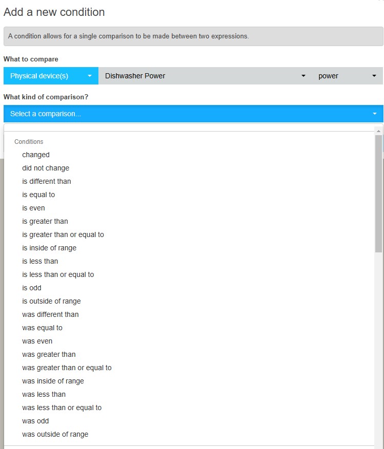

So in RM for all the comparison what exactly do they all mean
more then
< less then
= with line
In
changed
increased
decreased
increased by over
If you are new to RM, maybe check out Webcore as well, since you are not yet deep into RM.
It would be a simple rule in Webcore, as there are options for this scenario where you do not have to keep track of anything:
You probably just need rises above and drops below with two simple rules. You would put both rules in a "piston" and name the piston.

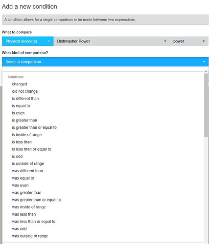

@JB10 so im trying to do the same thing with the washer , however the washer will sit for 45 seconds or so at 1 watt . So i need to have a rule that says if washer drops to under 3 watts and stays there for 2 minutes then close virtual contacts . Would you mind explaining how to write that rule in RM
Sure. You could use a Wait as the first action before checking the value again. So, something like:
Action
Wait for Event - Elapsed Time of 2 minutes
Simple Conditional - If Watt is below X value, set Virtual Contact to closed
Basically, the Wait will just count the time. The Simple Conditional will check to see if it is true, and if it is, set the contact as you want.
