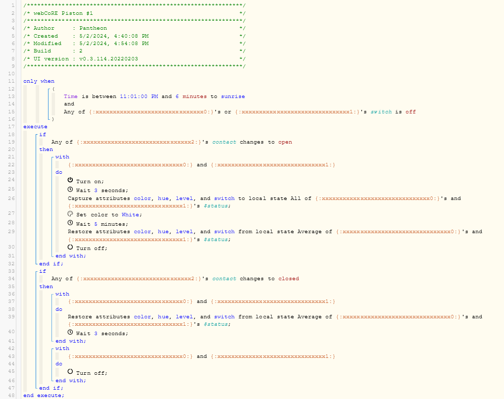

Need some advice... I'm trying to create a Webcore piston to turn on a pair of exterior RGB bulbs and change the color to white when my front garage door opens, then restore them to the previous color and turn them off when the door closes OR after 5 minutes. I've accomplished everything except the OR 5 minutes part. Unfortunately I'm not sure how to accomplish 'Door Closes OR 5 minutes elapses part. Line 45 is the critical point. I have it set up with a Logical OR Group, I', just not sure what the 2nd part of the Group needs to be.

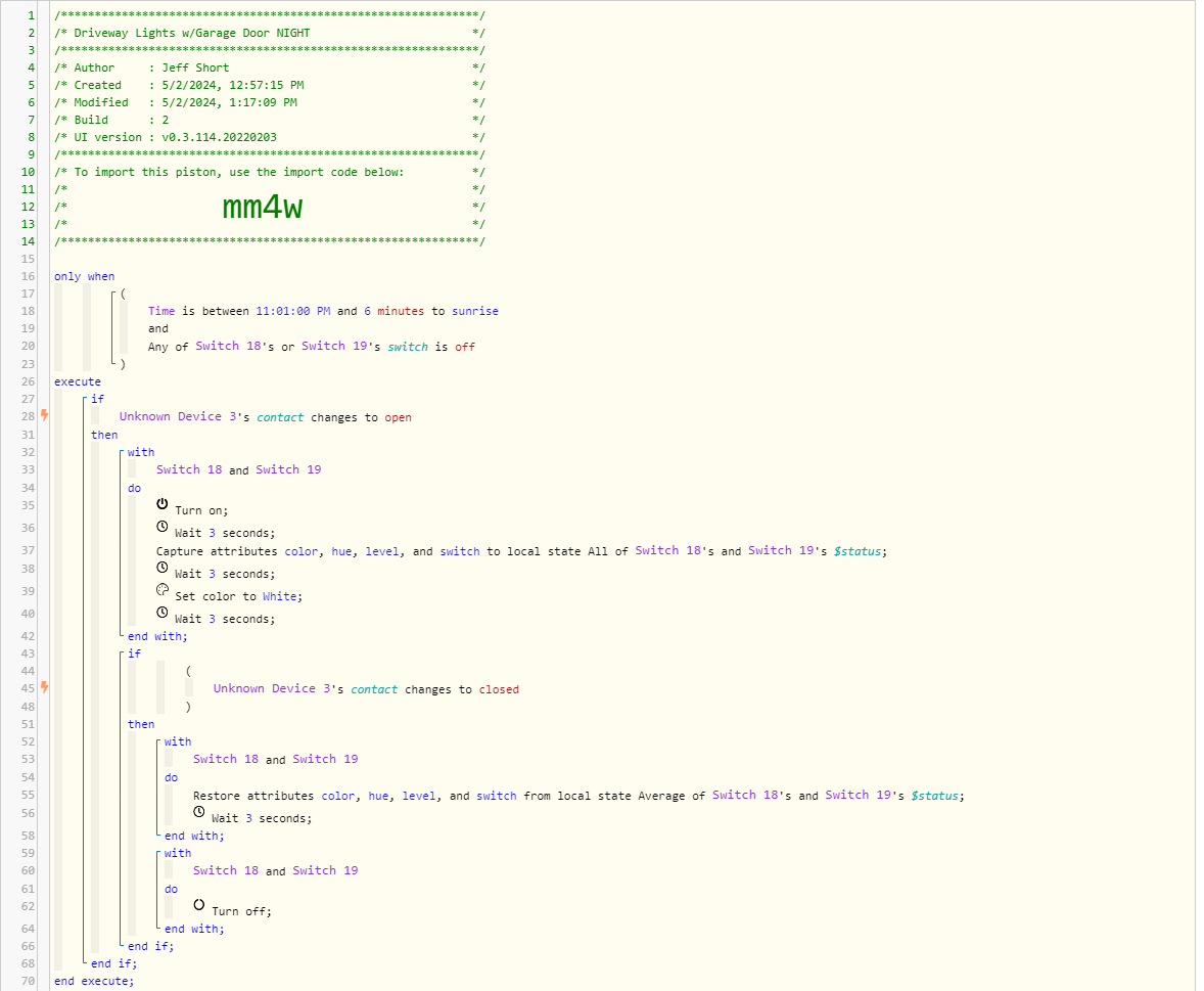

Try importing the piston using the code in my green snapshot and put rgbw bulbs in the first 2 slots and a contact sensor in the 3rd.
Then, go to line 38 in the Piston. Hit "Add A New Condition" below "Contact Changes To Closed". I'm certain that will clarify what I mean.

I don't think your original piston will work as written. Are you trying to add a WAIT statement at line 38 as part of the IF condition? You cannot do that.
Try loading piston code XXXX that I listed above. Fill in your devices, and see if that works for you.
Edit : sorry, code z3jsm
