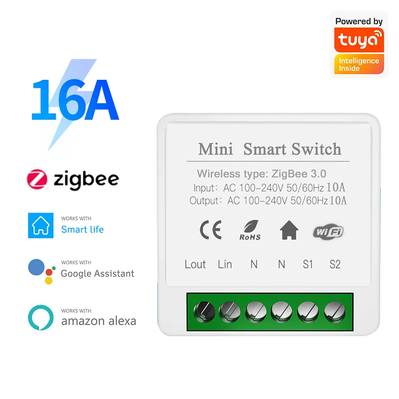

i bought Tuya ZigBee 3.0 Smart Light Switch 16A Smart Home Automation DIY Breaker Supports 2 Way but it doesnt seem compatible with the way my 2 way switches are wired ...which is as shown
the wiring for the smart switch is
Knowing that I'm limited to the left box has the hot/neutral coming in and the right box has the wires going to the light and there is 3 wires between the 2 boxes.... I can't figure out WHERE to put the smart device within those wiring constraints ...is it even possible? OR is there a different product that would work?

Are you in the UK? It would appear so by those diagrams you show above and the device in question. It would probably help to get specific advice if you could tell us which country you are from. As one example, in the USA we would call that a 3-way circuit, so I hesitate to give too much advise until we are sure that we are on the same page.
Take this for what it is wort, but I don't think you have enough wires to do what you want with that device. You could probably reconfigure some wires in each box, and add a button remote at one of the boxes to make it all work.

I have installed the $7 smart switch in a single switch config and it works great.
I've looked at Shelly, Sonoff,etc and can't see how to make any work....Hoping I'm missing something : )

that diagram only works if the line and load go to box 1
in my case the line went to box 1 and the load went to box 2
That's what I thought at first - But "Later" realized both the Hot-Line and Light-Load come in one box (which is the correct way for any wall switch type) and the Line-Hot was sent back across to the other box via the white of the 3 wire (White / Red-Traveler / Black-Traveler & ground) cable. Disconnect Line-Hot from that White wire and connect to module S1 to work. The dead giveaway would be one of the 3-way wall switches has only (one cable) 3 wire & ground connected to it only.
Where as the way you are describing has (1) 2 wire cable for the travelers and a separate cable for the Hot-Line and Neutral... (Double Check Both Boxes) Carefully...
sounds like you lucked out and the load and line went to the same box...
