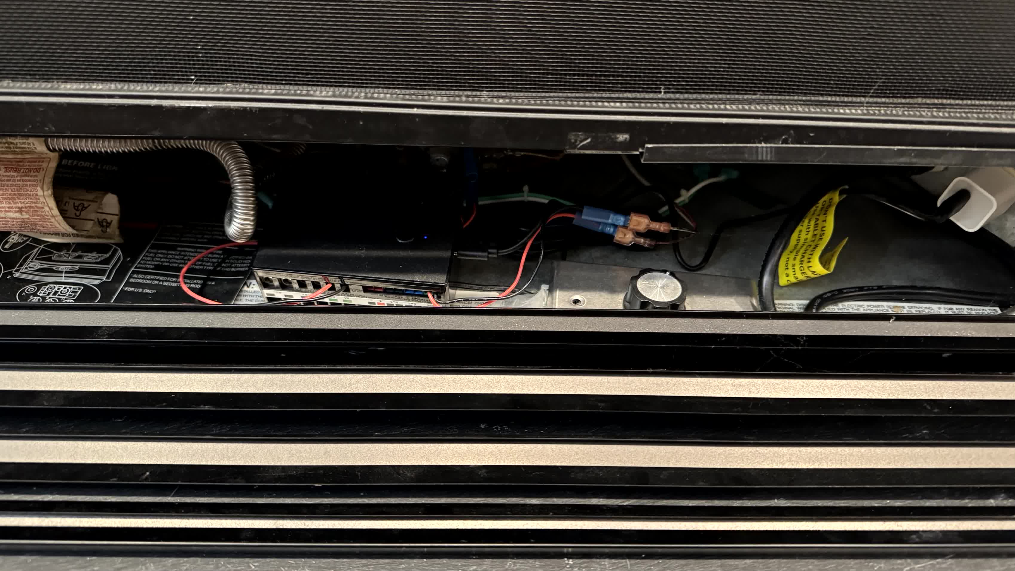

I am now considering keeping my dumb thermostat for the esthetic and form factor but adding a relay between the wires from the thermstat and the TH terminals of fireplace. Since I am very new to relays and not 100% how they work, I assume this will give some smart control over when the circuit is closed (thermostat calling for heat) and the Millivolt valve gets the signal to open the gas, is that right? So if I leave my thermostat on accidentally overnight I can lower it using a temp sensor and the relay, yes?
I am accurate in assuming that if I turn the thermostat to off that the relay will not have any impact on the millivolt valve operation?
Also, since the relay and the USB cord will be underneath the appliance, are there any issues with heat? I do have a 120V outlet for the blower.

My relay is upside down compared to the Zooz diagram (center left. The USB-C power brick is on the right. A relay like this acts slightly like a 3-way switch - changing the state of the dumb wall switch or the smart switch will cause the relay to determine whether to close or open the connection on R1. The knob is to control the speed of the circulating fan that I installed.

That said, I am a little confused on how a relay works, is it really like a 3-way light switch? A 3 way light swicth needs both open or both closed for the circuit to run power, is that how a relay works? I assumed the smart switch would be in series and provide more smart control when the dumb switch was on (closed) and not do anything when the swicth was off (open).
