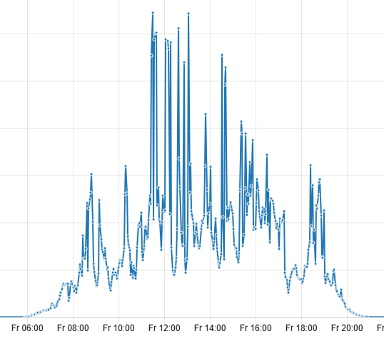

If your willing to DIY one, I used a nodemcu paired with a BH1750 lux sensor running Tasmota and mounted it in a waterproof project box with a clear lid. Power it with a spare usb charger. Mine has been outside for 3+ years with zero issues.
Bring the sensor into HE with Tasmota sync drivers.
Here's the graph from yesterday.
