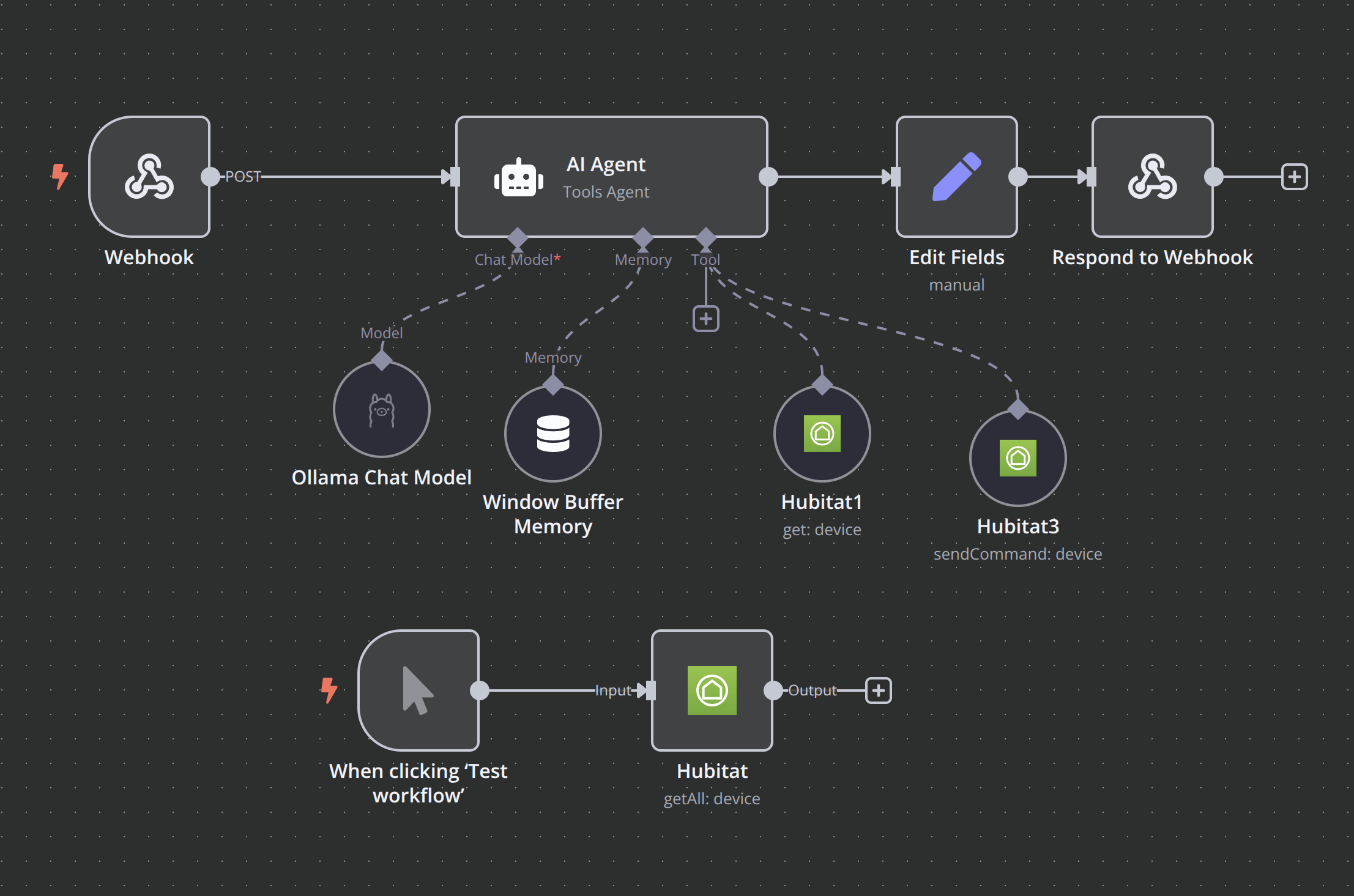

I've also shared a small screenshot as an example for curious.
