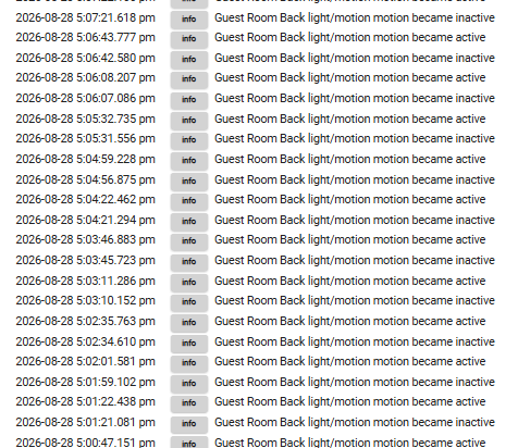

I'm having crasy motion flip flop on my end. Here are the logs I have. Randomaly, started the top of the hour? This is the second time it has gotten in stuck loop of motion-no motion going crazy.
The only way I have found to stop it is to physically walk in the room turn the light on, then off and then it stops.
