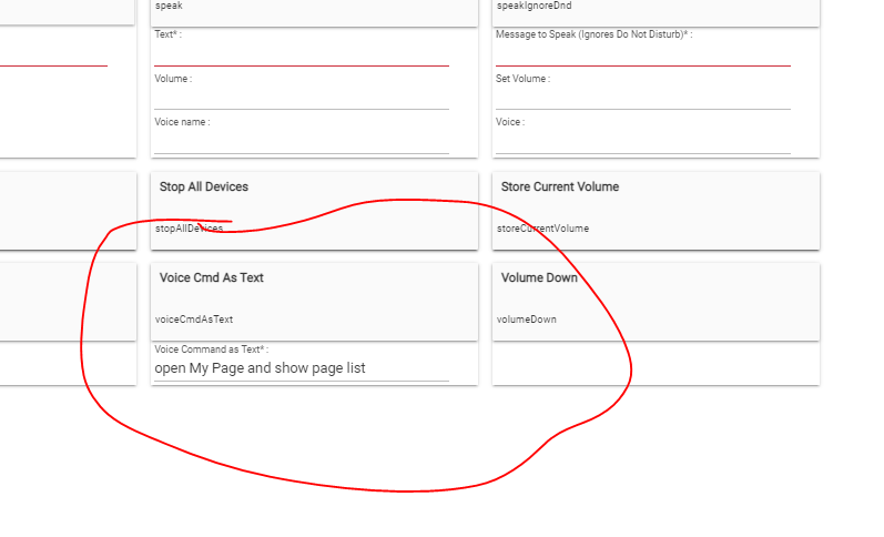

Do you use Echo Speaks? You could easily set up a rule that runs every 5-15 minutes and executes a "Voice Cmd As Text". I don't know how long it is before Echo times out and returns to home screen.
Or, as an alternative, you could put a motion sensor next to Echo Show and run that same "Voice Cmd As Text" when motion is detected. It's going to cause a problem when you are using Echo Show for other things like listening to music though.
