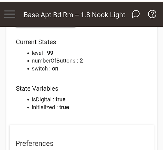

My Zooz switch shows it is on in the Hubitat app, but it's not. And the physical button doesn't work anymore?
I have a very simple Z-Wave home. I have only been getting into it for the last couple months.
I started with a test area, my basement apartment. As an additional note this is new construction as of 2021. However the house itself is over 110 years old.
I installed a bunch of Zooz switches and so far, once I figured out how to wire them. They all have worked great no problem.
One of the last switches I installed was the Nook by my bedroom. It has worked fine until a day or two ago.
In the app it shows the device on and when you try to turn it off, you can't. But the device is not on.
The physical paddle does not work either. I'm not sure how to fix it.
Help?

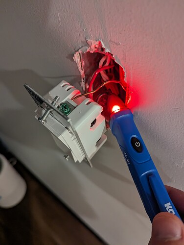

I just pulled it out and put a voltage tester on it.
The line/black is hot.
Neutral and load are not.
I'm guessing the switch is dead?
Probably, only thing else you could do is pull it and wire it on a test bench (cut off extension cord) with no load. If you are not even getting the LED on the switch it is toast. If its less than a year old Zooz will probably replace it for you. I think if you have it registered on their site it is also extended to 5 years possibly.

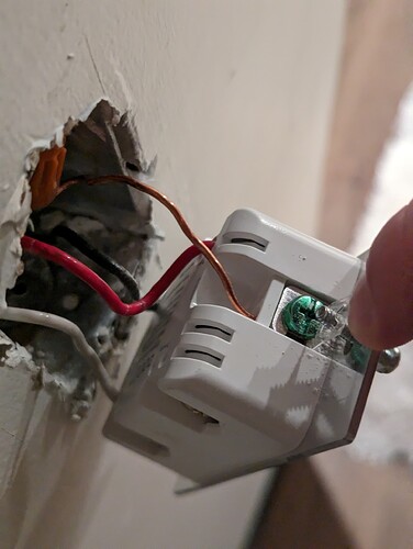

One other thing, I see the load is a red wire, which is not typical for a light. Would normally only see that with a light/fan combo, switched outlets, or a 3-way switch leg. Unless the light run is wired with a 14/3 and black is live while red is switched? Does it also feed outlets or something?
I don't know enough about electrical to know how it's wired on the light. What I do know is that the electrician did his own thing. The light worked for a while, and nothing in the house changed.

I agree. Its likely dead. I suspect that the reason there is a black and red, is the line (hot) actually comes into the light fixture box, and the person who wired the switch used 14/3 so he could switch the hot without pulling two wires to the switch.
@agnes.zooz can you help out here?
S.
Ah yes good point, that is very likely. Saved a little wire that way instead of running a 14/2 drop to the switch then back up to the light. At least they ran the neutral down to the switch instead of just a hot loop.
