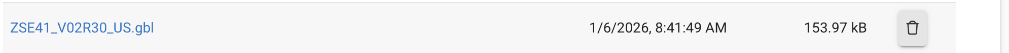

The driver says I have 2.20 device firmware. There's a 2.3 version that I'll try, although it's possible it's already there, just not reported on the driver.
Now, I have to remember how to upgrade the firmware, lol.
edit: Well, the 2.3 update is in my firmware files, so I must've updated it already:
Highly unlikely the device firmware would fix this. Something in ZWJS is getting out of sync causing the reporting to be backwards. I believe this was a much larger issue early on, have not seen any other reports of it recently.
