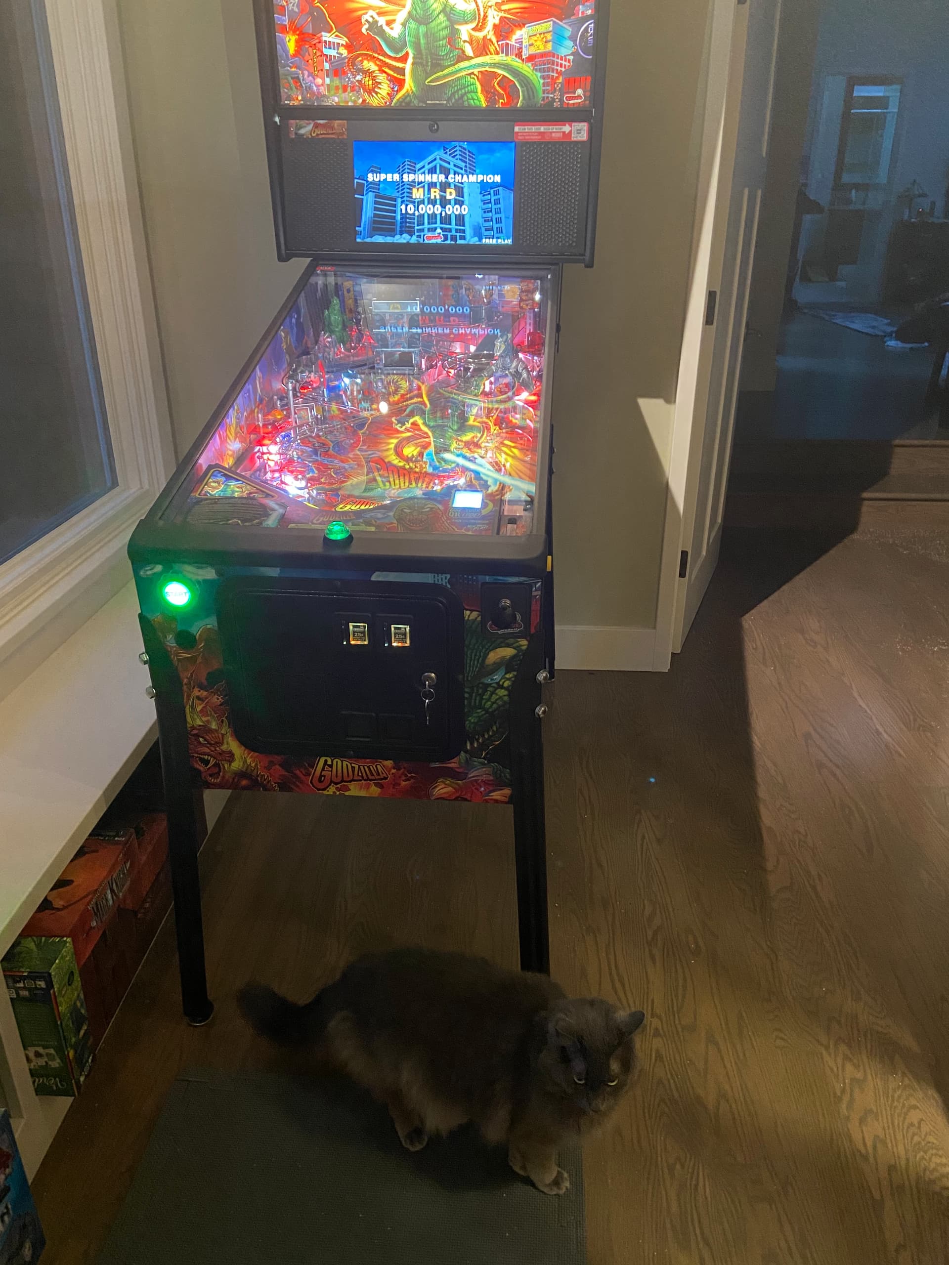

Pictures or it didn't happen...
With my kitty Nezumi modeling it...
Godzilla pinball machine.... seriously jealous...
Yeah... She's a keeper!!! And no, she doesn't have a sister.
Meanwhile, wife: New cat bed, check! :heart:
