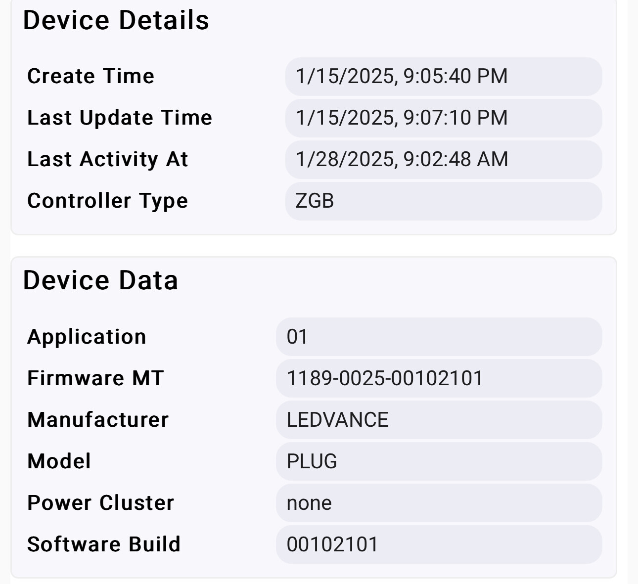

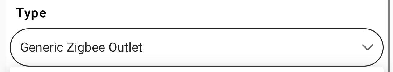

Any idea why such a popular name brand device doesn’t have a specific device type vs the generic zigbee outlet? How does one go about requesting one get made?
It was on channel 20 I just updated it to 25. Is yours set to the generic zigbee outlet for the device type?
What are you missing that's not covered by the Generic Zigbee Outlet driver?
There's no point in making/maintaining multiple drivers that are all the same outside of their name - that's why these various "generic" drivers exist.
I'm actually using Markus's generic outlet driver with presence detection, although that's no longer necessary, since HE updates now reflect connectivity. Generally drivers have little to no effect on stability, assuming the device is properly initialized at pairing.
