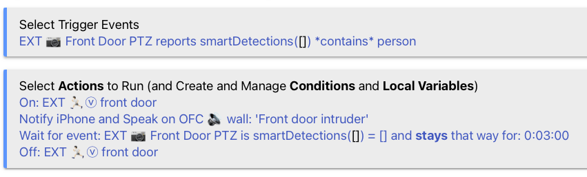

I ended up with a very expensive motion setup. I'm using Unifi camera smart detections. Since they can tell the difference between general motion, people, animals, and vehicles it works really well. On one camera I use vehicle and person. On another it is just person.
With this setup I was getting one false alert a week. I reported the false alert and for the past couple of weeks I have had no false alerts. I don't know if there was some sort of update, or the cameras learned, I've just had better luck. My last false trigger was June 13th.
If I didn't already have the cameras this would have been way too expensive. Otherwise this is the best motion sensor setup I have had in the past ten years.
This is what the front door trigger looks like. It sets a virtual switch that controls my exterior lights.
