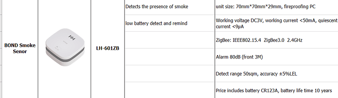

My pursuit to find Zigbee Smoke Detector that works lead me to Konke/Bond
Posted on here several times, recently, trying to find Zigbee smoke detector that works with HE
Ordered a bunch of different detectors from Alibaba and finally found one that works, and the build quality is superb too (i think it's a quality product)

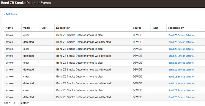

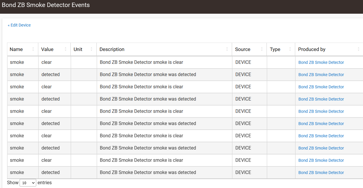

I tried several drivers, and the HALO SMOKE ALARM driver seemed to work!
Pressed TEST BUTTON and event got detected!

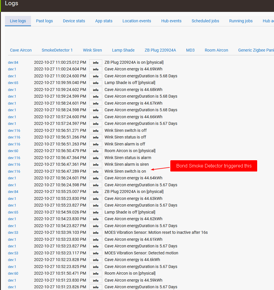

I tried to create a rule that triggers the WINK Siren on smoke detection...
Pressed TEST button -> triggered Siren
Did actual smoke test on the device -> triggered Siren
So it seems to work!

  1. I find it strange that, even when i turn on the debug logger, the activities from the device isn't showing up on the Device LOgs at all

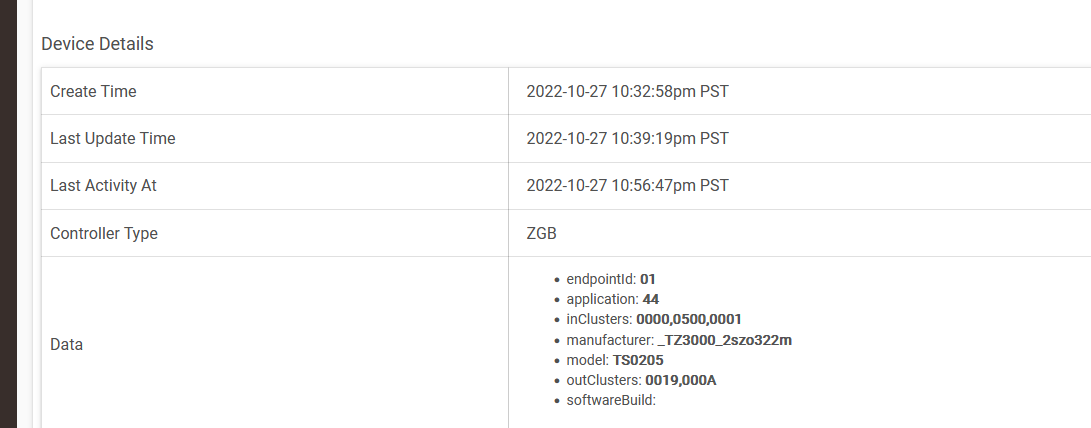

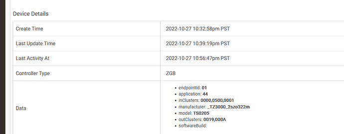

  1. While things seem to work already, I feel a bit iffy using a driver intended for another device... but is this an OK practice to do? I mean I tested em and it worked so...
If it works as expected, it is perfectly OK to use one and the same driver for devices that have other brand name. It may be just another white label, or the firmware inside the device is the same or is based on the firmware that the driver was initially written for... There are many similar cases with other devices too.

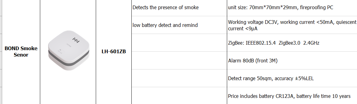

It's from KONKE
I ordered directly from the manufacturer (we import products from China for my Company and Projects). Sometimes they need volume order to produce units for you but if they have stock they can sell you samples.
