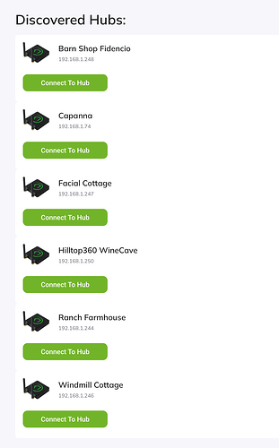

This is very suspicious! I am looking at findmyhub.hubitat.com and I see my local hub as per usual. In addition to the norm, I now see 5 unknown hubs showing on my LAN.
Anyone see this type of activity before?

What happens if you try to connect to them? Are those ip addresses in use on your network?
This happens when your ISP shares your public IP address across multiple households (Cox, for one, does this sometimes).
Is not suspicious, but very rare. Last time it happened was in November 2023: FindMyHub yields strange host - #6 by bobbyD
Wow. That sux.
Nah, it's harmless. We have this problem at our factory too, which is served by Cox (along with a dozen others in the same building).
Well, confusing at the least!
If I try to connect the response is " the site is unreachable". I have not cross checked them with other IP addresses in my network
Also, if I connect to my hub from the Hubitat elevation app I do not see them. It's only from findmyhub.hubitat.com
