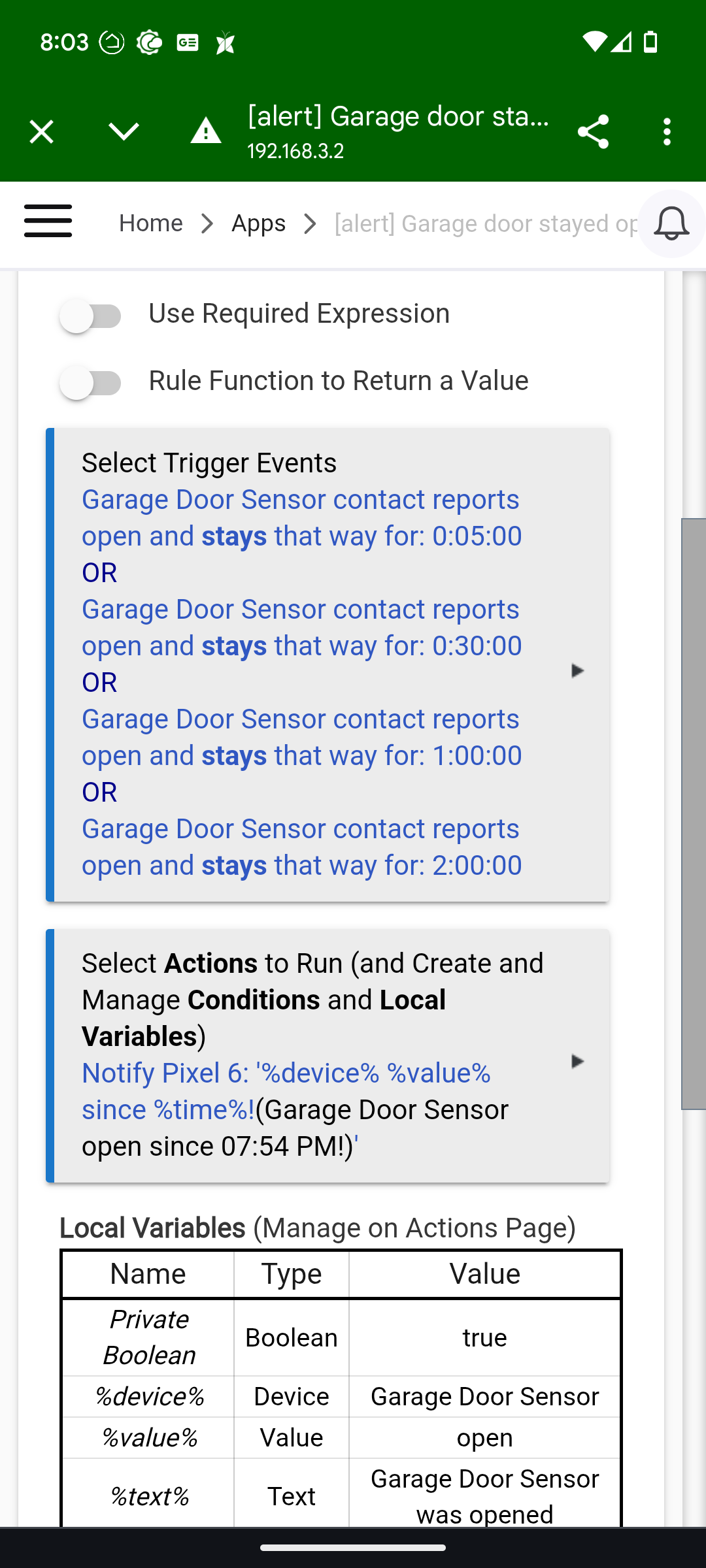

I saw Bug: Rule Machine with multiple timed triggers (using OR) does not trigger correctly which seems related to this and I thought this would actually solve my issue:

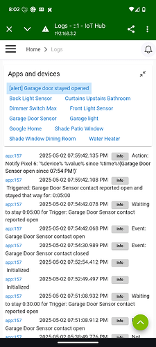

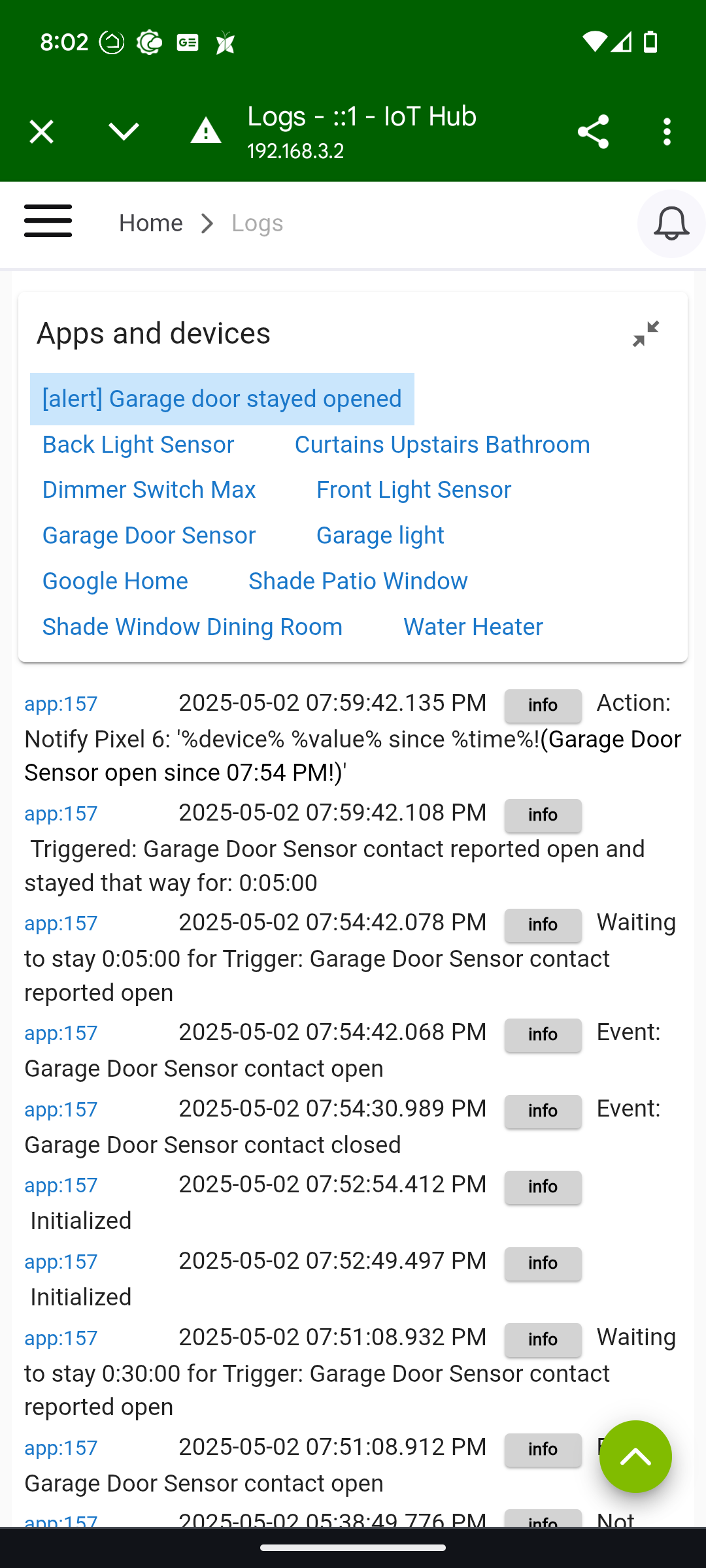

I have a rule that checks in my garage door is opened and sends reminders after 5, 30, 60, 120 minutes (please see rules and logs in screenshots).
However, it looks like only the first one triggers. I never get a warning for 30 minutes or longer. The logs don't seem to mention the other timers either.
Now, I could create multiple rules, but this will get noisy fast. And it quickly becomes a mess to manage. Especially since I intend adding more sensors and possibly more timers.
Having everything together in a single rule is so much more efficient.
Is this a strong limitation and I'll just have to bite the bullet, or is there a better way to go at this?

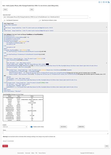

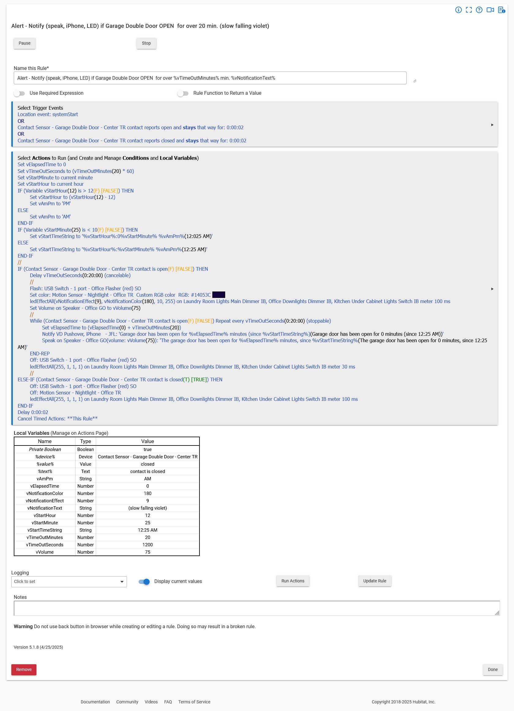

Here's an alternative approach:
I'm bored, so I was noodling on this idea... I don't know if this would work, but it's a fun thought exercise.
I'm not sure if the "Cancel timed actions" steps are really necssary, but I put them in there in an abundance of caution :person_shrugging:

Multiple triggers in an or only trigger once
. Its one big trigger.
I had this come up a long time ago. I know they recently made changed to allow multiple triggers with "stays" so things may be different now.. But, I was told that multiple stays will not work on the same Tigger event.
In other words "Garage Door sensor reports open" is the trigger event being subscribed to, and only up to one timer can be applied to that event. The additional triggers still use the same event to trigger, just with different timers, but since only one timer can be applied to that event, only the first one works. You'd need multiple rules or a different logic to do what youre trying to do.
