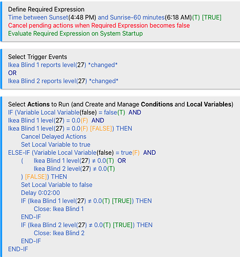

I think this summarizes my problem really well and was a big part of what I did not understand when I started this thread.
Looking at the log, I have triggers firing all over the place.
Good suggestion and I cannot deny that this is a good solution. I just need to figure out the triggers as explained above.
Can you please explain further? Pref with small example!
i put a block of code in my comment that shows the example
After way too much trial and error, this is what ended up working. The triggers still fire a lot of times but it gets ignored while the first round of actions runs.
So basically trigger(s) fire. -> Set boolean to false -> Delay -> Close blind(s) -> Blinds report level as 0 -> Set boolean back to true. Ready for next round.
